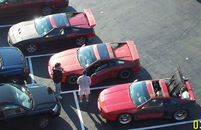

Here are some updated pics of the car from Daytona:

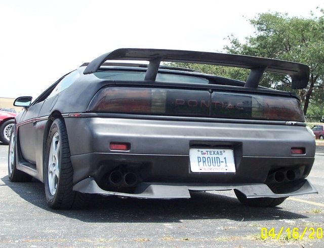

I call it the "J-Curl" because the idea popped into my head when I was talking to Curley about the front fender he used on the back of his widebody #15 car. He was looking at the front thinking what he had up front is what he needed in back. So I'm thinking what I need in the back of my car is the same thing I have up front.
So I cut the bottom off a GT rear fascia, (well actually it was my cracked Indy rear fascia) flipped it upside down and bolted it on. I'm still trying to figure out the best fittment but so far I think I like it. It balances out the front and the raised spoiler. And I got a lot of looks in San Antonio.

Looking good. Funny how GM parts can be mounted in different locations. Any close-ups from the rear? Include the wing pics too. And what show were you at?
I see that the red'ish has been absorbed by the black. It now has a mean-ish look like the "Dirty Rat."

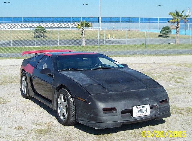

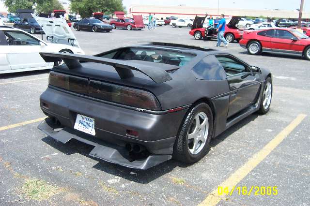

These pictures were taken at the Texas Round-up in San Antonio.
Since Daytona I spray bombed the rest of the car black. All that primer will have to be sanded off again, but it looks a lot better all one color in the mean time. It does resemble the dirty rat more now.
In addition to adding the J-Curl spoiler I also did extend the wing tips two inches. They looks a lot better in the pictures than they really are. I still have a lot of fiberglass and sanding ahead of me before they are done.
Notice how a chop top V8 tends to attract a crowd.
I don't have a lot of chop top adventures to share but I got a lot of stares...like people didn't know what they were looking at.

I (6'4") had to sit in it to see how much headroom there was. Way more than it looks like. In fact, I'd say it is very comparative to my stock Fiero seat with sunroof. The curled and extended rear wing really does look like it belongs just like he's done it. Good accent.
Not sure what you officially call the lower rear fascia mod, but it's very unique and only a little rough right now but is gonna really look nice when he finishes it.

The rear lower fascia mod I call the "J-Curl" Thanks for the good words

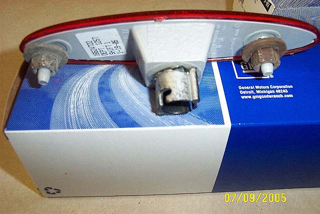

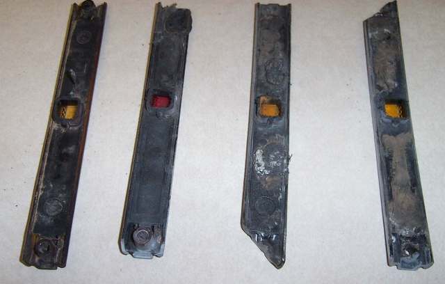

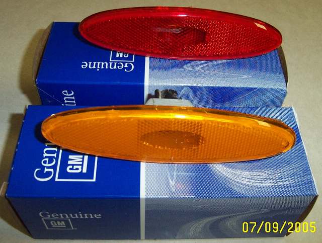

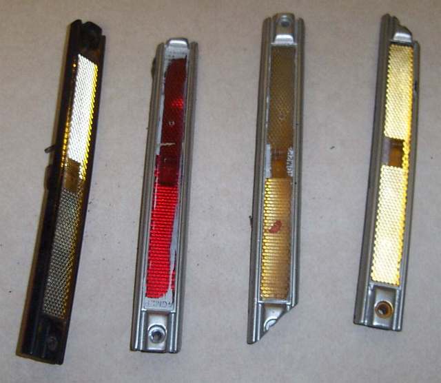

Once again inspired by Madcurl,
He is using Corvette C6 marker lights for his #15 choptop. That gave me an idea to try the C5 Corvette lights. The only problem, C5 only has rear markers, the fronts are integrated into the wraparound turnsignals. So perusing GM's catalog I discovered they make amber markers for the rear lights for export. No reason I can't use them on the front.
I ordered them from Eckler's in Florida. Ironically I used to live only a mile from there, never thought I would be ordering parts for a Fiero from there. Anyway to mount them I briefly considered replacing the Fiero bulbs with Corvette bulbs. But I figured out an easier way, I replaced the back ends off a scap set of Fiero marker lights. And to hold them on, I bought all kinds of nuts, but what works best are Fiero seat nuts.
How are they being fitted to the chop top...you'll have to wait and see.

That is cool ...was wondering if the chop was on the backburner gorilla glue should hold them together...watching your progress.

Report this Post07-15-2005 03:06 PM Click Here to See the Profile for madcurlSend a Private Message to madcurlEdit/Delete MessageReply w/QuoteDirect Link to This Post
You Sir...are a genious. I---in turn will copy you in mounting my side lamps.

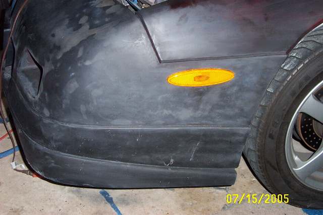

Any more fron pics of side lamps?
edit: Oh yea, good work on joining the two parts (bumper and fender) w/o smoothing them in.
[This message has been edited by madcurl (edited 07-16-2005).]

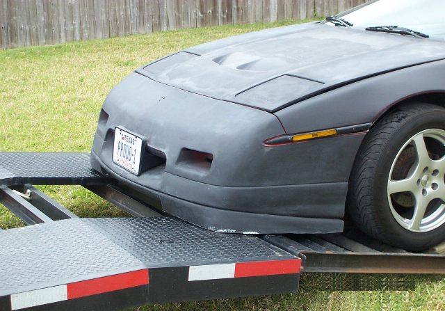

Well I confess that's a photoshop, but the real thing will look a lot like that. I'm making pics so my bodyman knows what I want it to look like. Since he doesn't speak english a picture is worth a lot more than a 1000 words.
I don't want it completely smooth. I think the Fiero looks better with a beauty line. I'm just not a fan of the big honking trim.

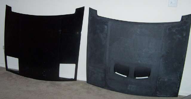

I'm also redoing my hood vent. I thought I could get my hood to sit flat by adjusting it properly, but no luck. I'm going to cut out the Aus stage II and start over on a hood that's nice and flat.
What do you mean by, "not flat"? Is the hood bent?
jscott1
Posts: 21676
From: Houston, TX , USA
Feedback score:    (15)
Total ratings: 415
Report this Post07-16-2005 09:53 PM Click Here to See the Profile for jscott1Send a Private Message to jscott1Edit/Delete MessageReply w/QuoteDirect Link to This Post
Take a look at this shot. I had some gas shocks I put on there to replace the stock strut. It pushed the hood up a little bit. I have them on my T-top and it's fine. But this car because it was hit in the front the structure has been weakened a bit. I thought I could make some adjustments to get it right, but I made two mistakes. One I waited too long and second I glassed in my stage II while it was under the pre-load. That deflection in the hood is now more or less permanent.
Not a huge deal though, that hood was one I bought for $25, since then I have aquired several hoods so I just went out back and got another one. It shouldn't be too hard to glass in the vent again. I actually will probably do a better job this time because I have a little experience; that was the first fiberglassing I had ever done.

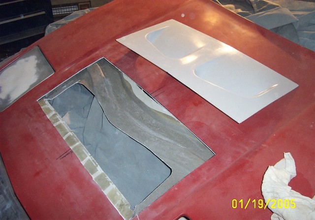

Time for an update...
The Aus Stage II is transferred over to the "new" hood. The only thing more fun than cutting a hood is doing it twice. It was a lot of work, but it was worth it. The new hood is a much better fit.
The Diffuser is trimed to a new shape. I need to add another bracket int the center, but it's okay for now.
I've done all I'm going to do..next stop:

Can you say, "ready to roll." Looks good and I like how you change the rear difuser. Do please give us up to dat pics while the chop'r is in the oven. Hmm...where is Exotic Rida?
