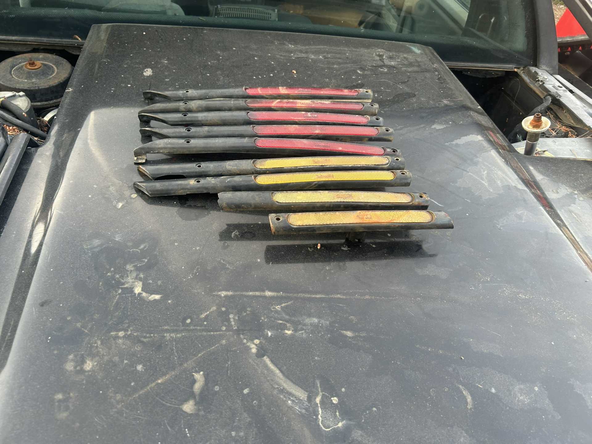

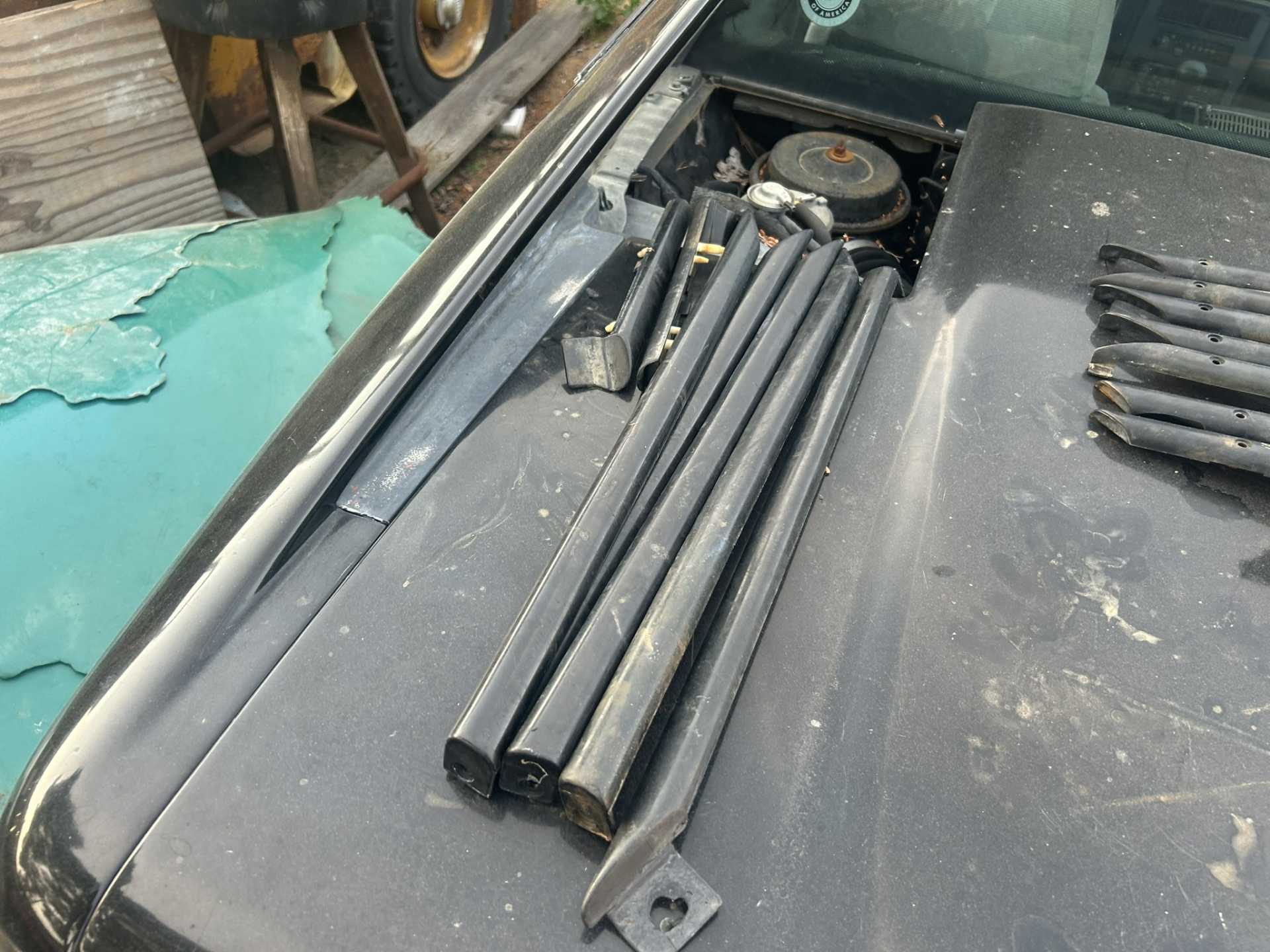

Taking all the black parts off the car to refinish paint or super clean and found 50 pounds of dirt and various debris tucked in every nook and crevice. No idea how this stuff even finds itsway into these places.

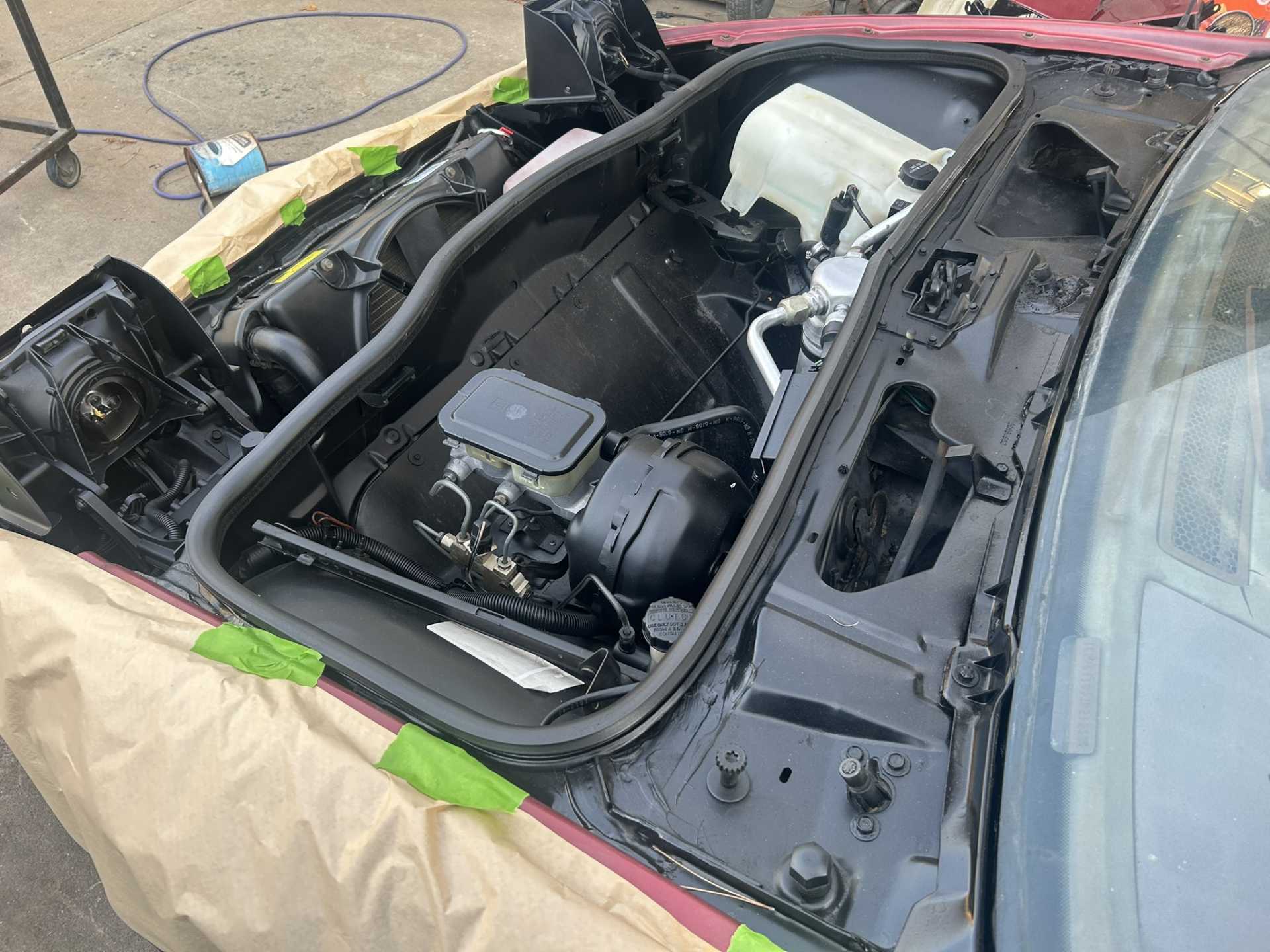

Had I not been busy doing other things I wish I would have done a thorough super deep clean and disassembly. It went through the basic clean,pressure wash but that just doesn't cut it.
So kind of doing it the hard way now.

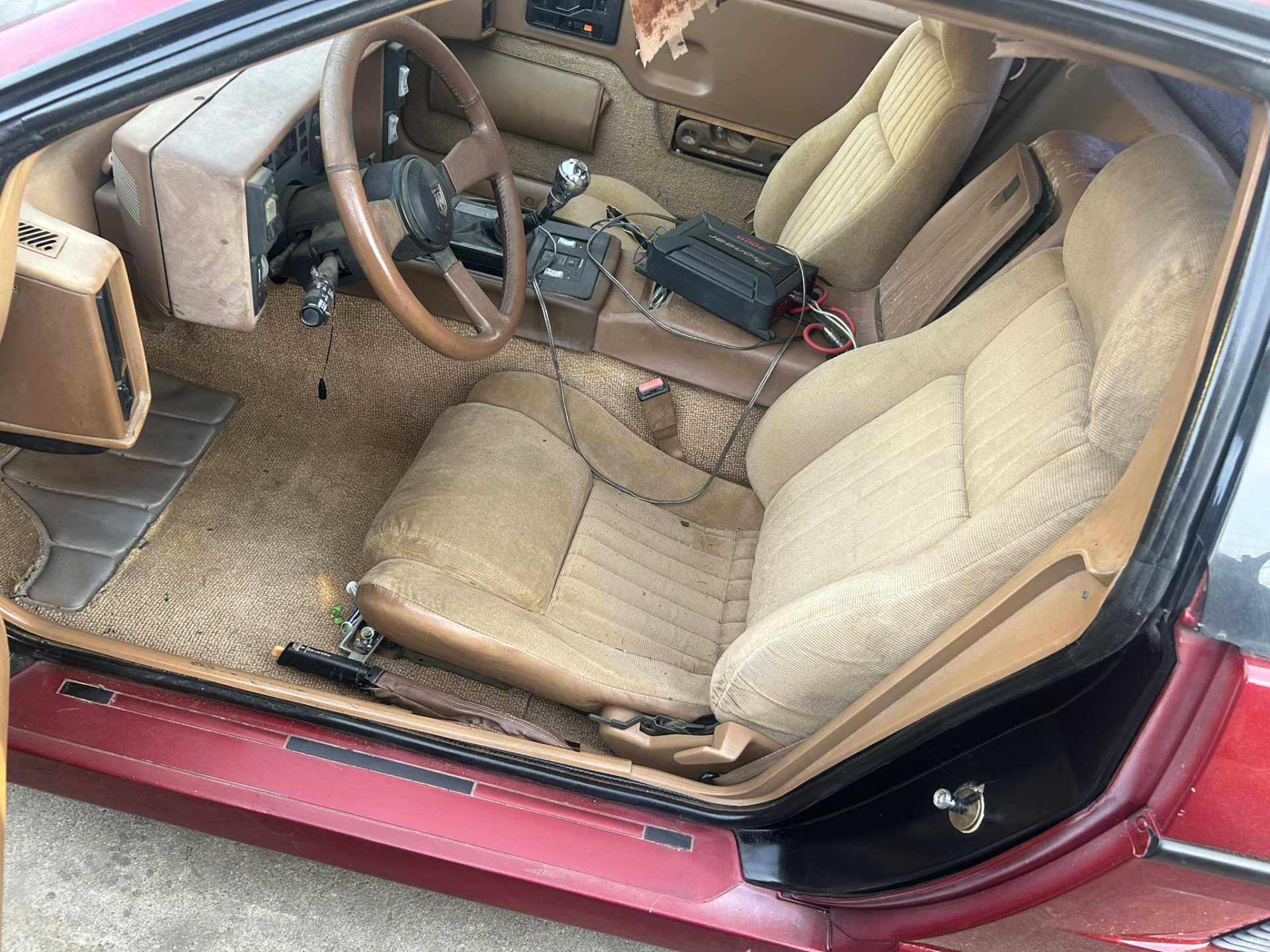

The seats are in 9 out of ten condition. Nothing wrong with but not brand new is all. I intend on buying the covers from RW that are exact repro looking but they are covers. I want to keep these Old seats in great shape.
Center console is warped bad . I have other oem centers I'll be putting in instead of these. I'm toying with the idea of getting after markets from RW The car isn't ever going to be some 10.000 mile all original car and it has after market upgrade 12"brakes already anyway. so I don't think tasteful upgrades shouldn't hurt value. Opinions?
The dash is really sun discolored and I want to get some plastic interior paint to make them look good again but can't find exact colors anymore. I thought Fiero Store sold them but I guesse not anymore.
I have replacements that are in gret shape but not wanting to change out the whole dash.
Head lights are rebuilt and working spiffy.Door jambs still need to be done but I may change the carpet yet.

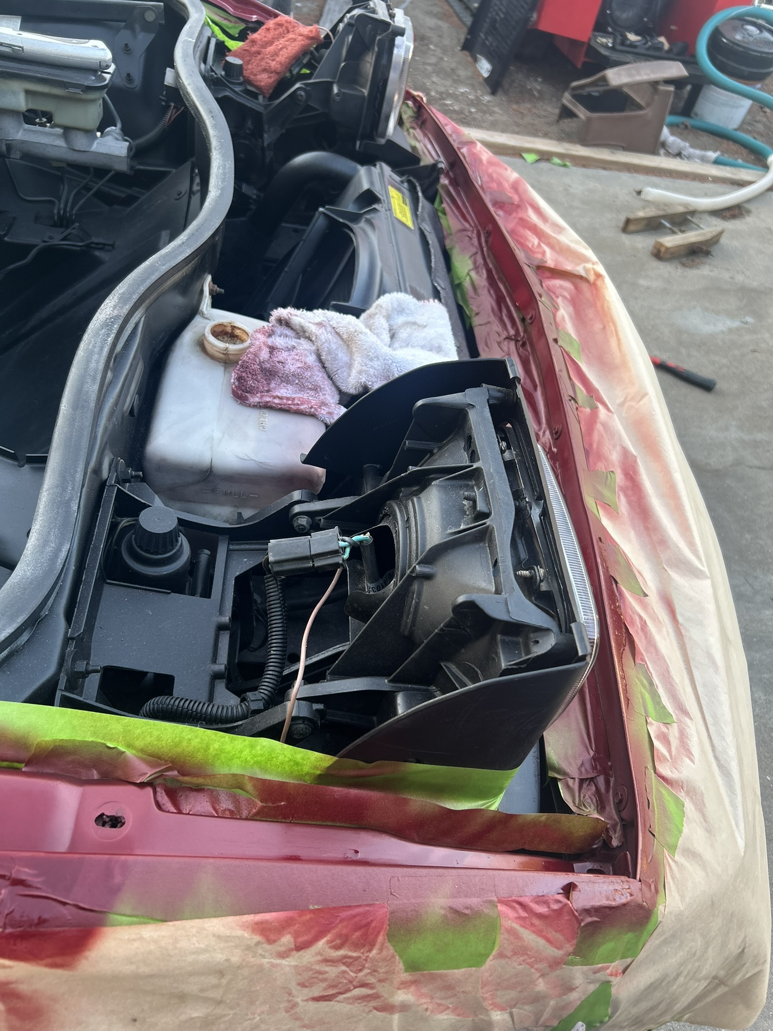

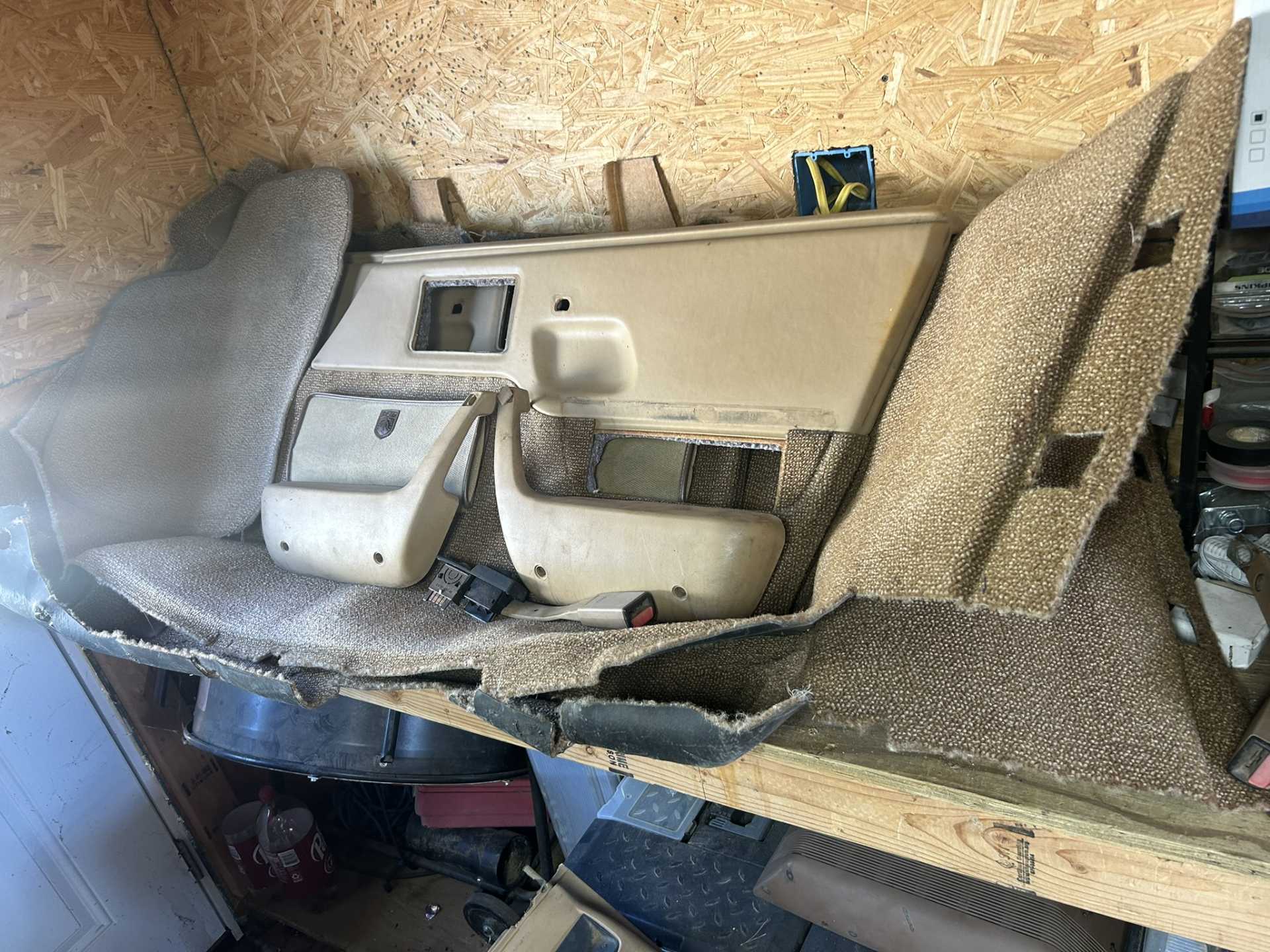

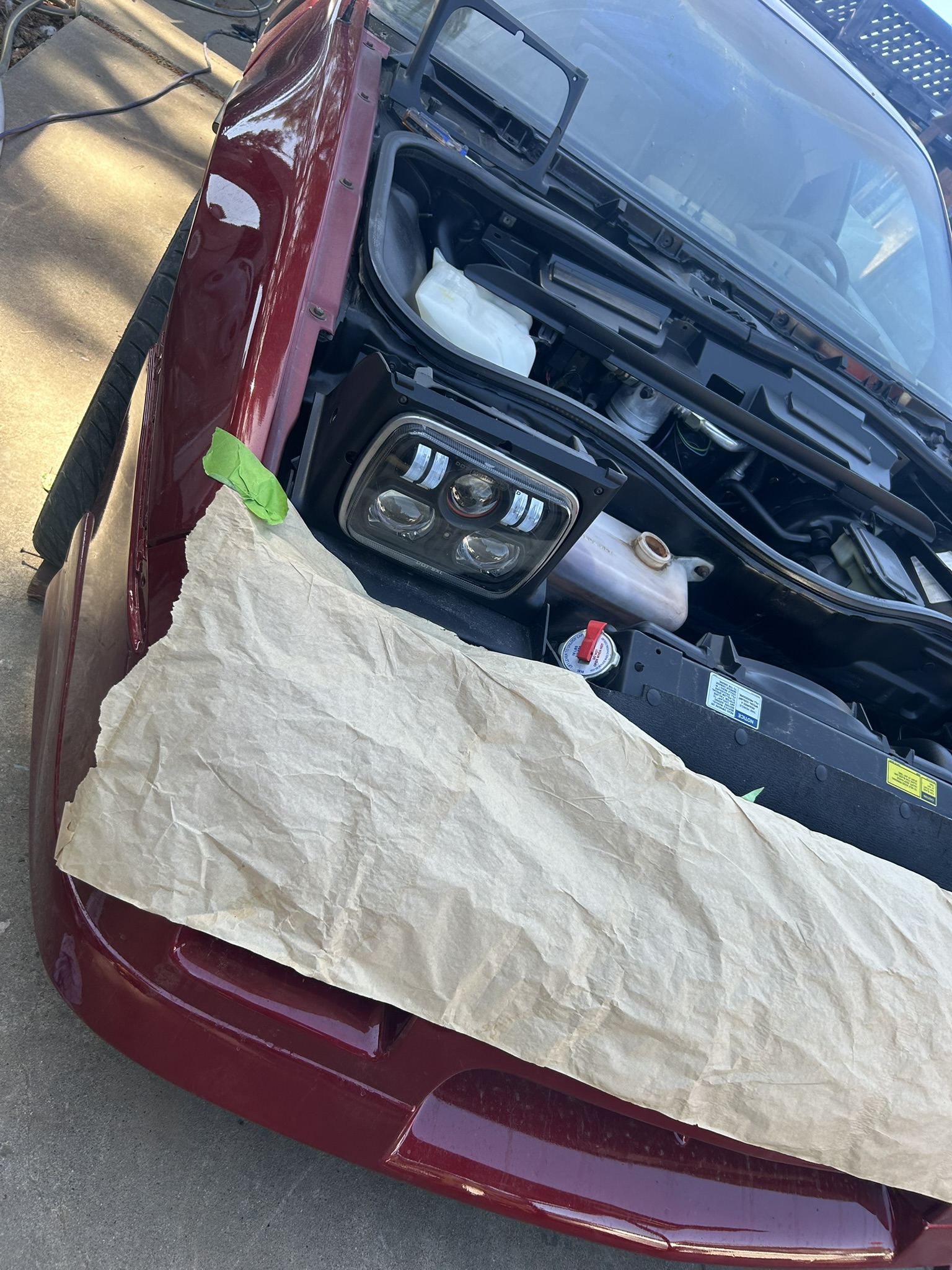

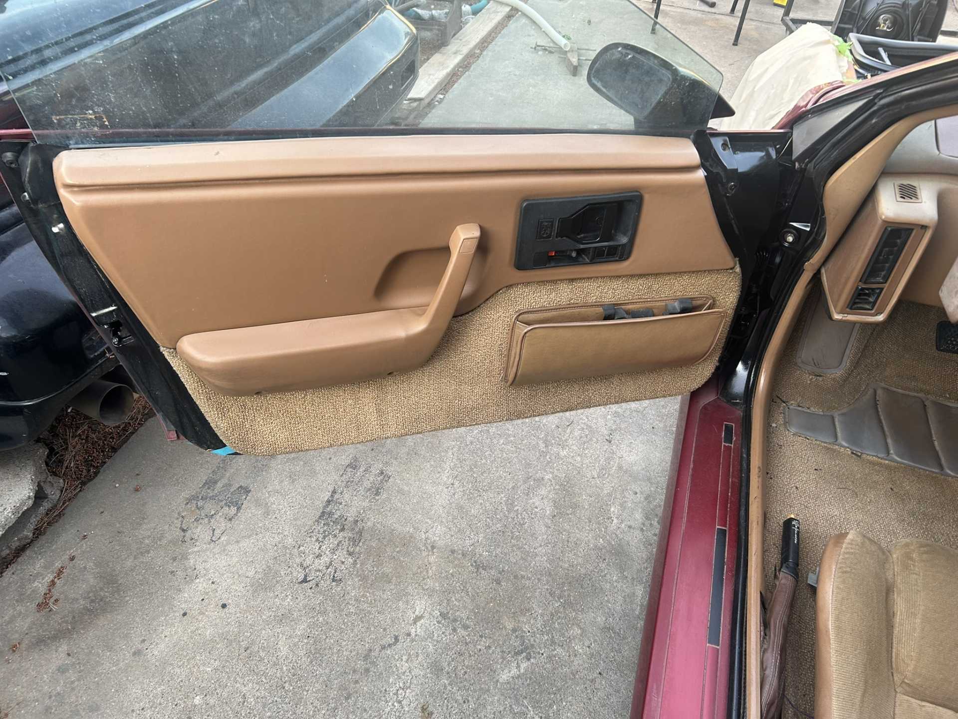

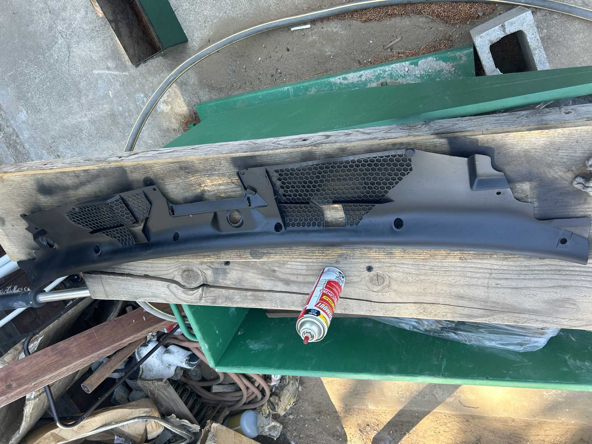

These are nice led headlights going in. Door panels and carpet are much nicer
Wiper cowl was brittle and had a hole so this one is from an 87 parts car that has been in the shade for 15 years. It's been a bounty of parts.
Still I need some Saddle plastic paint. I believe the code is wa62 intreor but I cant find it

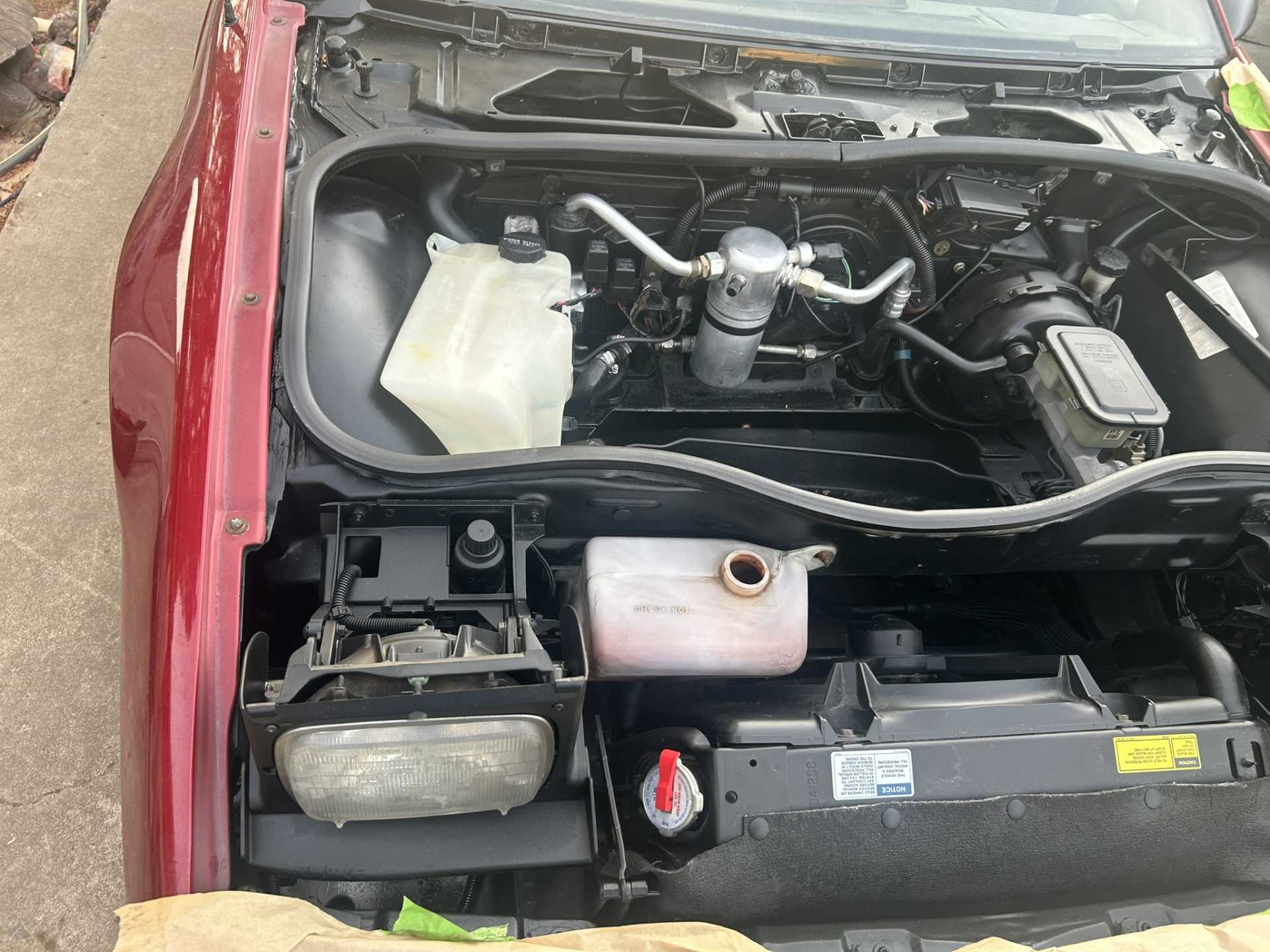

Unless you already bought a new one, you can make the inside of that coolant overflow tank look like new.
All you need to do is go to any sporting goods store, buy a small box of bb’s, remove the coolant tank, plug up the bottom nipple, pour in some bb’s and a homemade mix of soap, bleach, hand cleaner, etc., put the cap back on and shake, shake, shake till your arms fall off and voila, clean tank. 😀 Kit
pokeyfiero
Posts: 16246
From: Free America!
Registered: Dec 2003
Total ratings: 306
Report this Post04-09-2025 01:30 AM Click Here to See the Profile for pokeyfieroClick Here to visit pokeyfiero's HomePageSend a Private Message to pokeyfieroEdit/Delete MessageReply w/QuoteDirect Link to This Post
I was thinking Muriatic acid?

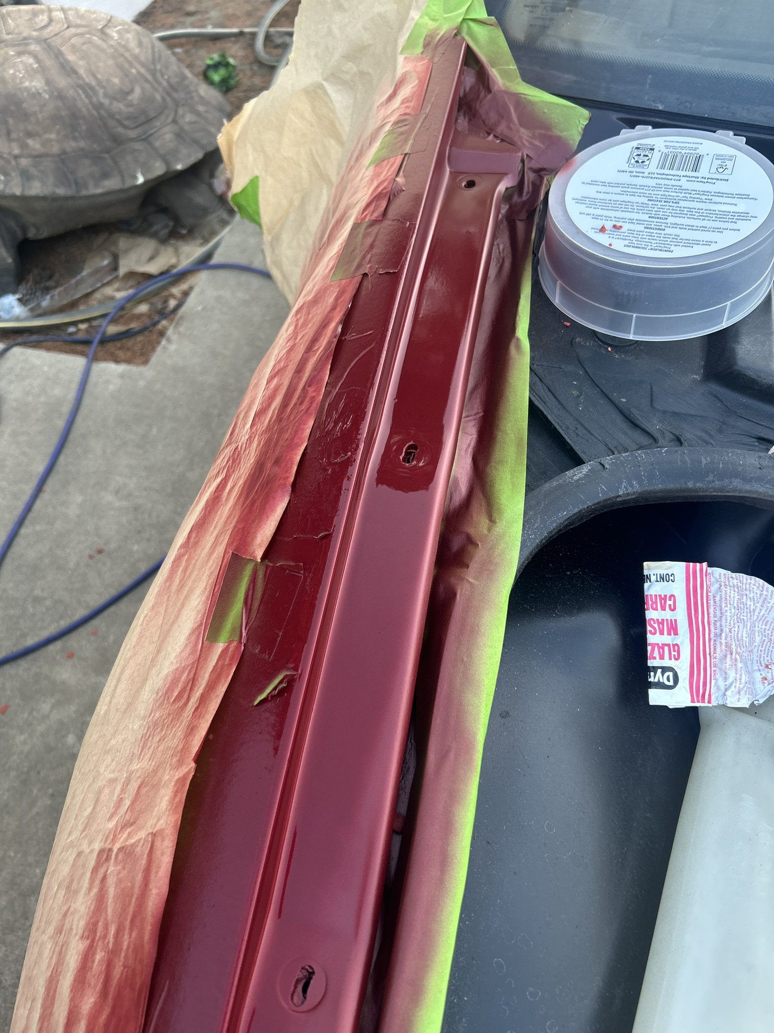

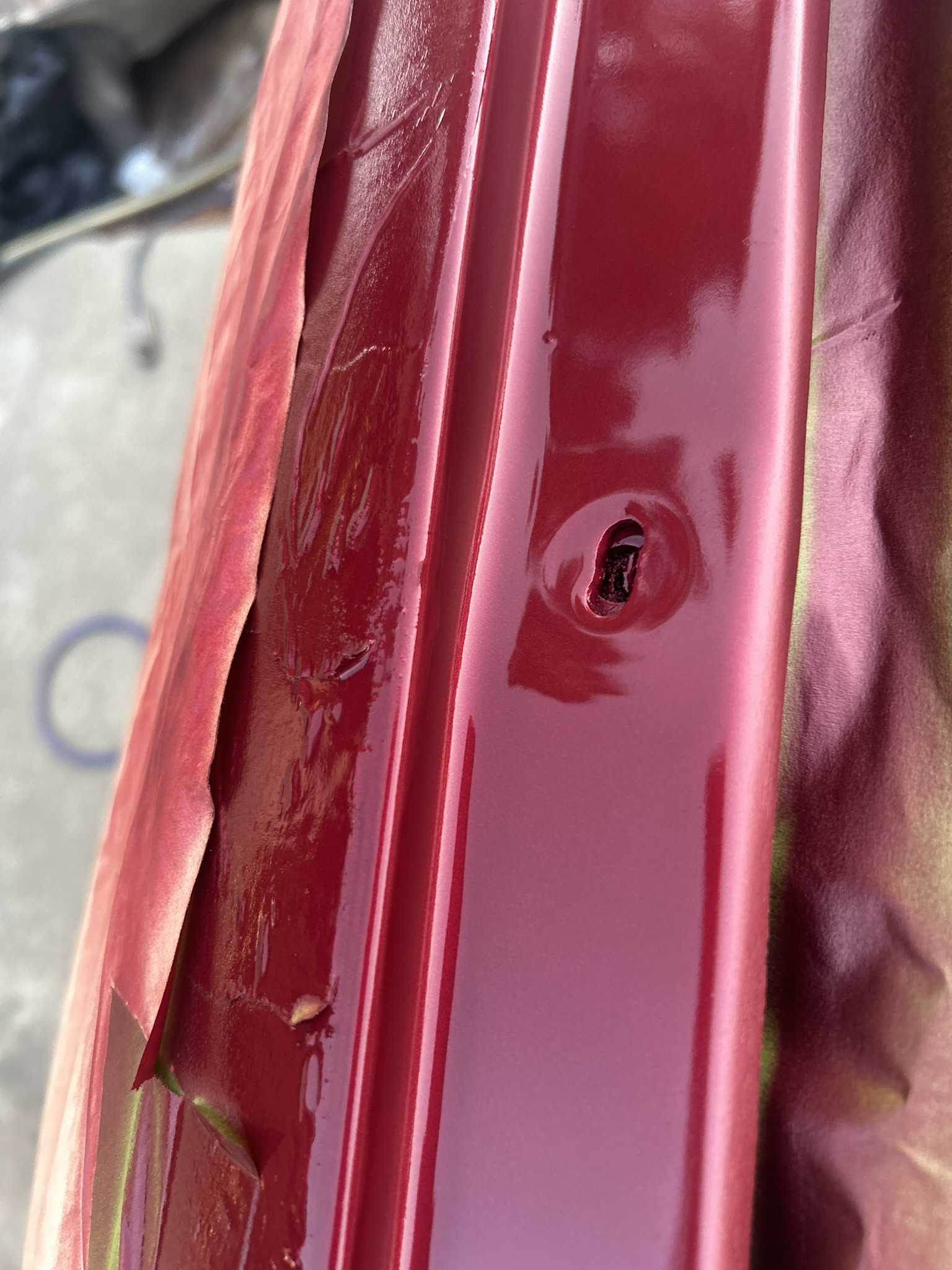

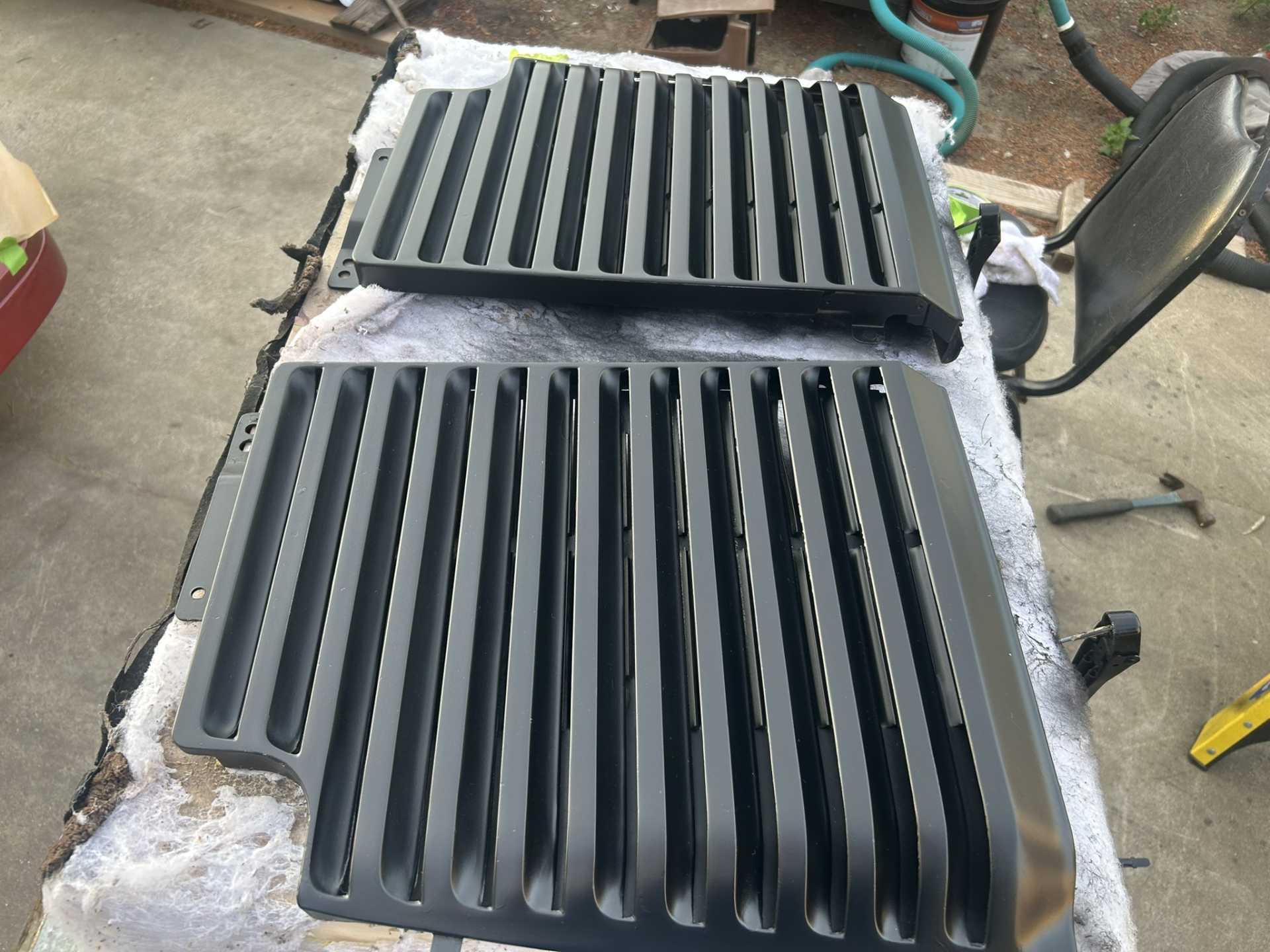

Going to have to clear still.HAve a lot more to do until the whole car gets its first cut polish.

That paint came out really well! If you don't mind me asking though... when you remove the painters tape, you'll be left with ridges and such... what do you do then at that point to create a seamless transition? Do you buff it out somehow? Paint (other than "parts") is the one thing I've never really tried to tackle... but want to.
I used Oxalic Acid to clean my Coolant Recovery Tank
Muriatic acid is hydrochloric acid; a strong and very corrosive acid which I personally would not use.
Oxalic Acid is a 'weaker' acid and the active ingredient of "Bar Keepers Friend" cleaner
Hot Water and some "Bar Keepers Friend" cleaner worked perfectly!

pokeyfiero
16246 posts
Member since Dec 2003
Little wet sand with 2000 and buff. Possibly a little clear and buff again
