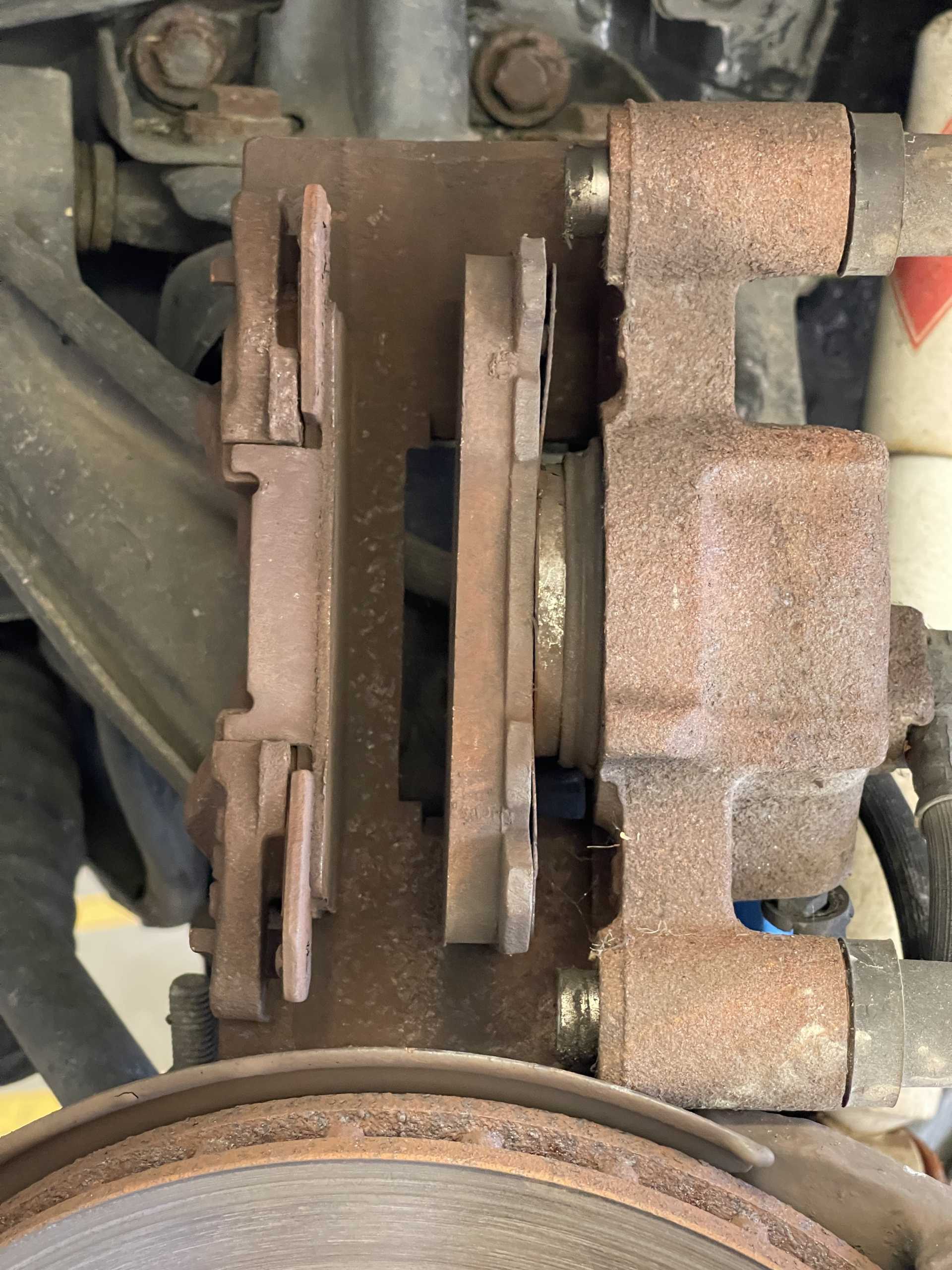

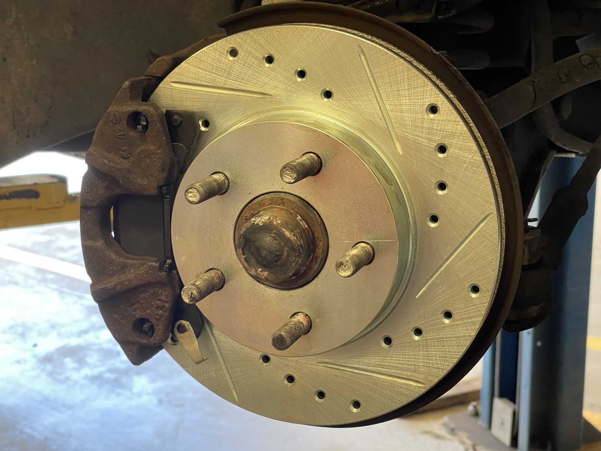

Thank you both for the leads. I replaced the GA fronts and stock rears today. There’s a special place in hell for the guy who designed that little clip on the rear brake piston/pad
Here’s what I found on the fronts:
Poor lubrication during the last brake job wore the outer pad quick. Cleaned, lubed, and away we go…
Interestingly, the seized sliders masked a soft pedal. I now see how the GA brakes make for a soft pedal. Will be changing the master ASAP! At least it doesn’t pull to the left anymore LOL!
