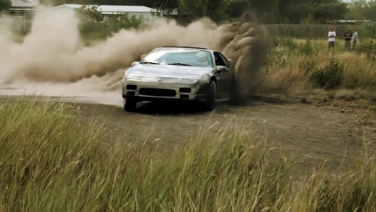

I plan on putting General Grabber AT2's on the stock 15" GT wheels.
I'm not planning on rock crawling with this thing, but I'd like to be able to get frisky in this: https://www.youtube.com/watch?v=HOEt_q28lLE

Looks like stock ride height to me
This one's had a little more work but still needs a better dif
