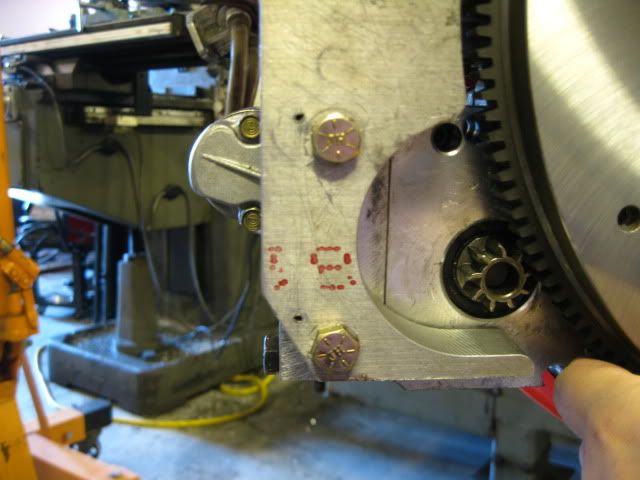

Clearance issues with starter. There simply isn't any room for the center port to have an elbow fitting on it and clear the starter body:
For my first SBC swap, I used a different bypass plate. With a little clearance work, it cleared everything and allowed both oil passages to be larger and exit the side of the motor.
Also, while you are messing with the starter, get it properly positioned and then pin both the mounting block to the adapter and the starter to the mounting block. Aligning the started with the engine in the car is quite a pain, so a little forethought now helps out a bunch later.

That's the style my 94 Burb has on the 350 in it, maybe you can pick up the different part of the remote housing at a dealer if they have a good parts person who is willing to do a little work. mine is because of 4 wheel drive or something else being in the way.
Steve
Are you sure the hose ports came out the side and not towards the front?
Here is a factory 4.3L 4x4 oil filter relocation setup adapted to work with a 4.3L swap I did about 8 years ago. It fits because this is a Zumalt style kit that uses a Nissan starter. Just comparing the pics, this one is too tall to clear the starter used with SBC swaps.
