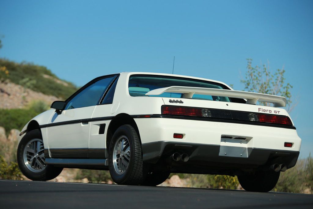

Hi guys im restoring my tail light from my 85 gt . I would like the tail light to be clear after restoration.
So I started by wet sanding the left tail light with a 400 grid , 600 grid and finally 2000.
The thing is that after sanding im still getting that foggy appearance on my tail light. Could the problem be from the inside?
By the way im hand sanding, is it better if I use a polisher?
thanks in adv.
My result still not clear enough
this is what i'm aiming for (clear tail light)
