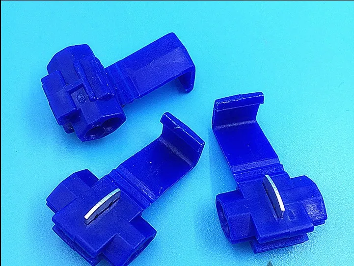

Funny enough I was looking at a wiring diagram last night and it made sense in what you stated. I have to make sure the OEM subwoofer amplifier is still hooked up to the wiring harness. If not; any recommended splicing clips?
Should I use these (if needed)
https://ae01.alicdn.com/kf/...iring-connection.jpg
fierofool
Posts: 13012
From: Auburn, Georgia USA
Total ratings: 153
Report this Post11-15-2017 09:53 AM Click Here to See the Profile for fierofoolClick Here to visit fierofool's HomePageSend a Private Message to fierofoolEdit/Delete MessageReply w/QuoteDirect Link to This Post
No. Do Not Use ScotchLocks. The best is to direct solder the wires and insulate them with heat shrink tubing. You can also get butt splicers in varying gauges to insert the wires into, but solder the wires in and insulate them with heat shrink tubing.
My experience with the ScotchLocks when building kit cars was horrible. Many of the kits used them in their wiring systems and inevitably the connections failed, sometimes requiring one to be a circus contortionist to try to find and make a proper repair.
