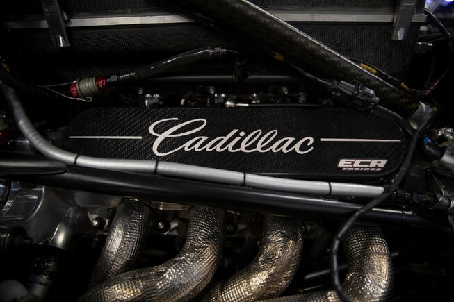

I believe I can get there with no problem and even higher, the question now is will the power be at that RPM.
With the previous valvetrain I could feel a bit of power loss at 6900-7200RPMs and I knew the problem was the amount
of mass the springs had to overcome as the RPMs climbed with the heavy SS oversized valves I was using. The engine had a peculiar sound, like valves floating.
And could not get the best out of the camshaft at the higher RPMs. I'm pretty sure I could've gotten another 30whp but the valvetrain was the limiting factor.
One of my worries at those RPMs was the stock rods I was using. They were ARP's bolt upgraded but still, my gut was wrenching when I saw the tack hit 7200RPMs.
That's why I decided to go lighter and going with beehive springs. The beehive springs I run now are made for endurance (LeMans, Daytona, Sebring, etc).
Every LS engine runing the IMSA prototype category uses the same part# and brand I'm using, they were not cheap.

OK, I wasn't sure if you were trying to hit a certain RPM goal.
Regardless, it'll reduce parasitic power loss, especially at high RPM. Also, valve float will be moved higher up the RPM range. But of course, you know these things. I'm just saying this for the benefit of other viewers.
