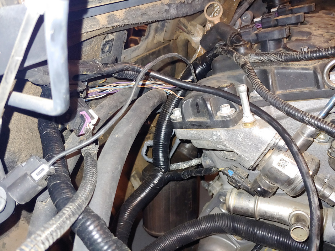

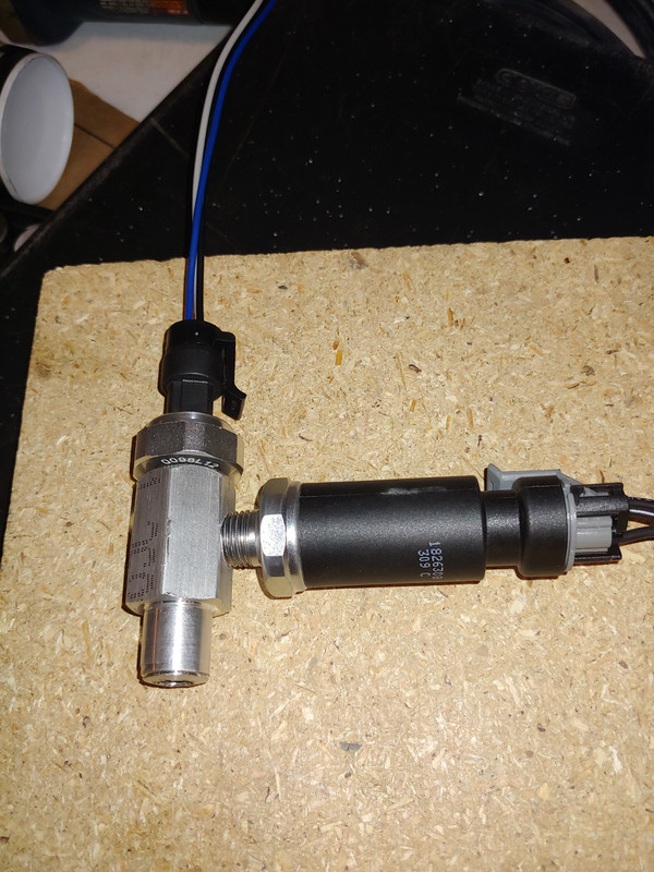

Ok, time to tap the community mind. I got my 88 in pieces and didn't see it when it had the engine in it. This cable and bracket was hanging in the engine compartment. The other end seems to go to the very front of the console tunnel. It is difficult to see just where, but it appears to be hooked to nothing? Does anyone know what it is ? The car is a 1988 and had an Isuzu transmission in it. Anything else I would tell you would be a guess.
Thanks,
Daryl

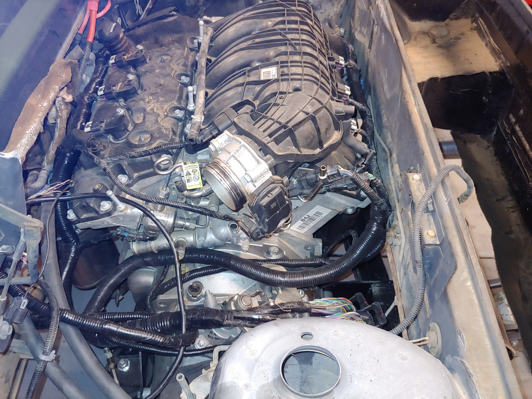

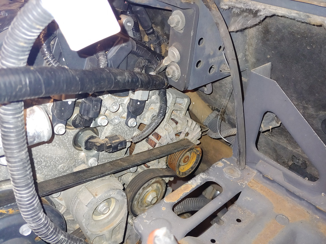

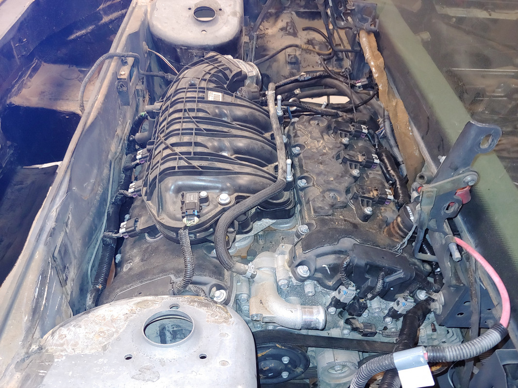

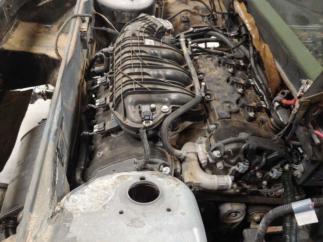

I did a test fit this morning just to make sure it is all going to fit. So far I think I'm pretty happy, that is until I find that first thing that I didn't notice.😝

How much clearance do you have between the valve covers and the front firewall and trunk forward wall?
After looking at your pics closely my biggest lf3 fear looks true... Not enough room to fit the stock compressor to IC pipes......plenty of room down below...just not up top........

Report this Post02-06-2019 04:08 PM Click Here to See the Profile for WillSend a Private Message to WillEdit/Delete MessageReply w/QuoteDirect Link to This Post
It clears the hinge box? That's pretty awesome. 3.4 TDC doesn't even do that.
And clears the right strut tower in an '88.
Did you remove the chassis side dogbone mount or was that done before you bought the car?
[This message has been edited by Will (edited 02-06-2019).]

Wow.... I thought an M30 in an E30 was tight, but that's incredible.

Report this Post02-06-2019 04:41 PM Click Here to See the Profile for Daryl MSend a Private Message to Daryl MEdit/Delete MessageReply w/QuoteDirect Link to This Post
Yes, the dog bone mount had to go. I took it out after the test fit in December. I still plan on finishing the complete tear down and clean up before the finish assembly, but these test fits sure do help me get an idea of what to do next.

It is pretty tight in both places up top. The heat shields had to go, but there is room to insulate with the aluminized blanket stuff. You are correct about the room down lower. I did sacrifice the bottom 5" of the trunk so I could do a relatively quiet muffler. To be honest, I don't think I'll miss it. My 87 GT has a removable shelf that sets in about half way down. I seldom use the bottom half.

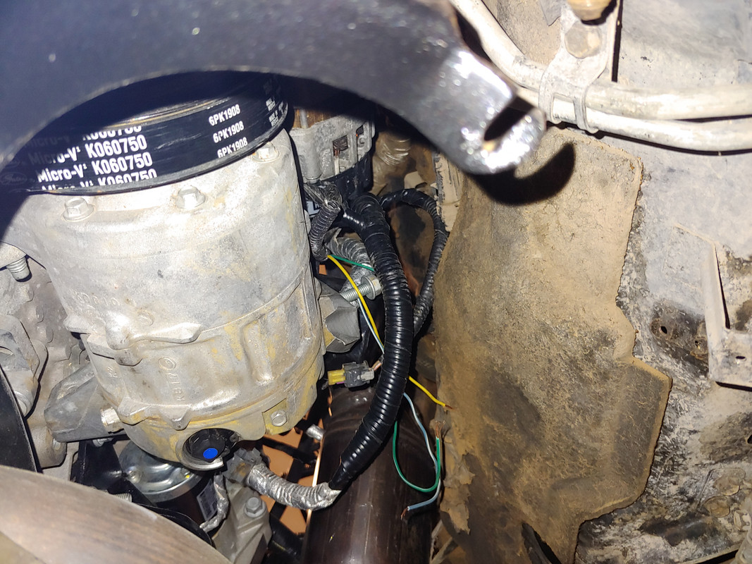

That is the stock 2.8 throttle cable. You need small hands and the center console skeleton removed to take the other end out.
[This message has been edited by fieroguru (edited 02-06-2019).]

Looks great for a first test. The cable you were asking about looks like a throttle cable. Not really sure though. Keep up the good work and thanks for posting the pics.

The engine looks good in there with plenty of room in most of the areas. I like how the air intake and several of the hose connections point forward... almost like it was designed to fit in there.

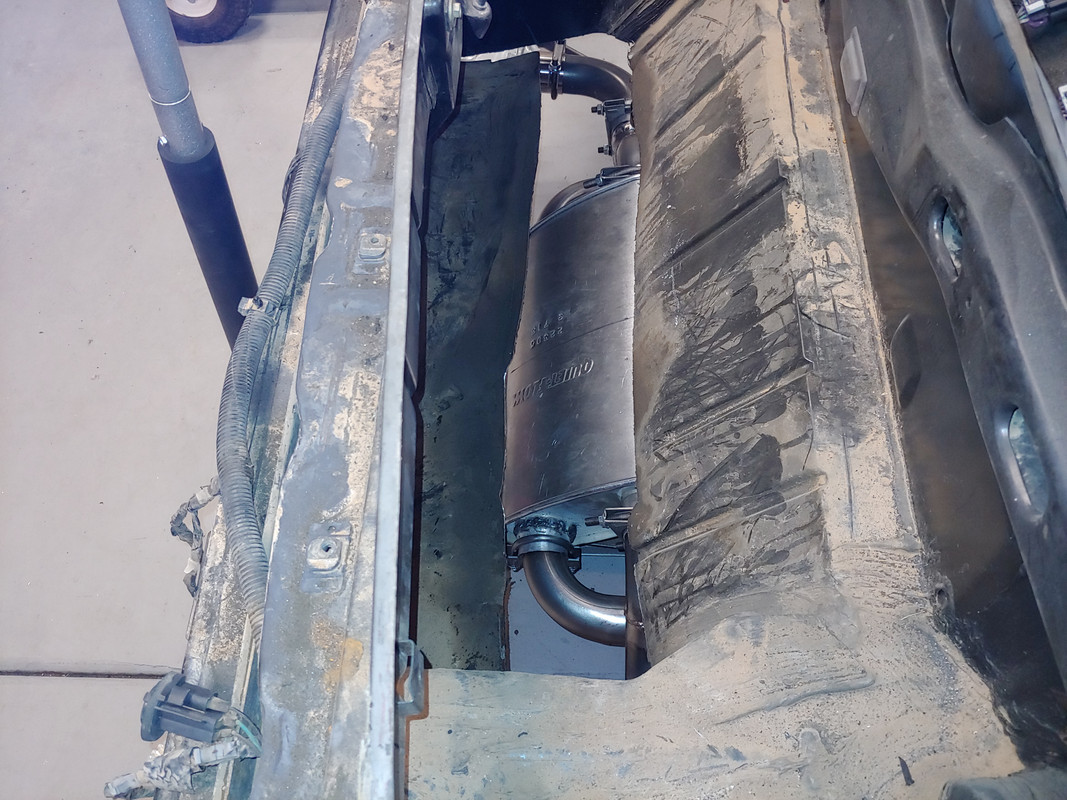

The only thing I noticed was the AC line missing from the compressor and the huge cat in its path to the passenger side of the car. It might take some creative routing and some good insulation, but nothing too difficult.
I am not a fan of engine covers, but that intake either needs smoothed or covered in my opinion.
Guru, I agree that the engine isn't pretty, but that will come later.

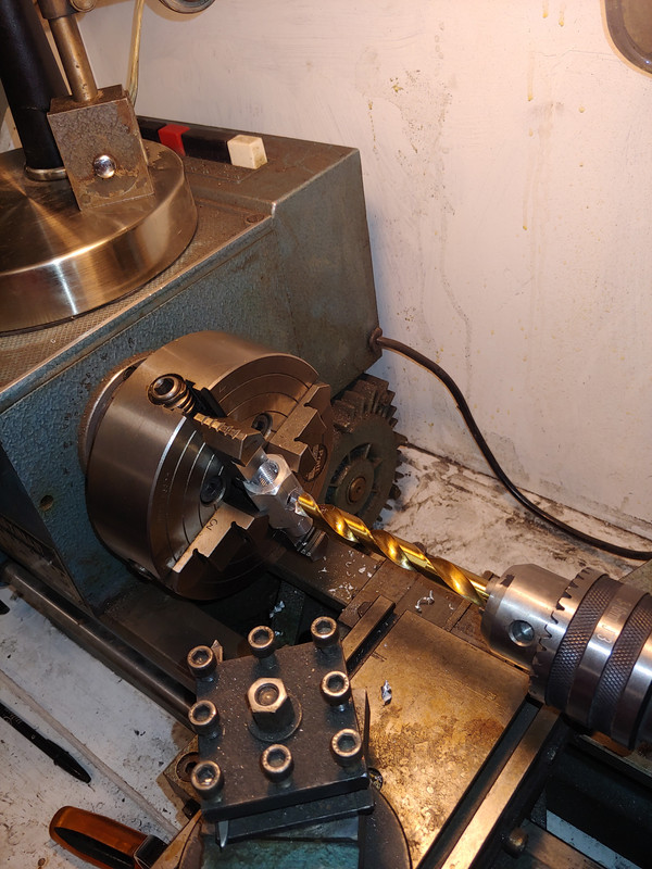

This is my solution for the oil pressure senders. Jus have to thread the 16mm part that screws into the engine.

Engine fits like a glove.
Handy to have a lathe around, isn't it?
I've been using my dad's lathe for the last few weekends straight that I've been working on my car.

Yes, having a proper shop is wonderful! This is the first time in my life I've had a real shop to work in. Retirement is proving to be quite fun! I just wish I was better at using the tools I now have.

The "sort star" v6 Northstar (LX5) is a huge chunk as well. But did fit.
Notice that the front Valve cover is under the deck lid and rear window, hidden from view.

Only the older C-series Honda V6's are 90 degree. The J-series are 60 degree, and fit the Miata just fine.
Interesting. Thanks!
Gives me evil thoughts dropping the current 3.5 into an NSX with twin turbos...

The 90 degree bank angle is basically similar between the two engines in terms of clearance to the firewall and trunk wall, but you have WAY more clearance to the strut tower.
