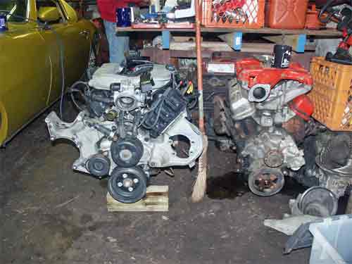

It looks like you have been doing the right sorts of things. The injectors may be just slightly large, but not so much that you will have issues with idle.
I've built two engines for these cars over the years. The first was a stroked 3.2 (.040" over using an 3.1 crank) with special low compression pistons and an IHI turbo boosting at 10 psi. Very reliable and very quick, and lasted well for almost 20 years. Custom Comp Cams stick designed specifically for turbo use and their roller high ratio rockers and springs, and forged custom Ross pistons to keep it all together. Lots of fun with Porsches that didn't have a turbo in there.
The second engine was a naturally aspirated engine based on a 3.4 engine, with a Crane 272 cam, a bunch of head work and a reworked Firebird/Camaro intake manifold which isn't perfect but gives you a starting point way ahead of the stock Fiero manifold. The removal of restrictions in the head, and manifolds (including the use of a 62 mm TB), and including exhaust opened things up very nicely and the engine no longer runs out of steam below 5,000 - t pulls cleanly to 6,000 at which point you might as well shift as power is dropping off.
If any of that is of interest, you can see pics and description at http://www.britishv8.org/MG/BillSpohn.htm
The engine is installed in a 2000 lb. fiberglass bodied MG and we estimate that it is around 200 bhp.

IIRC the F body intake flows significantly better than the necked down Fiero intake, but not as well as the Truleo, nor probably than a reworked Fiero with added volume. Anyone know of a thread with the various flow stats?
The F body intake, reworked internally and bored out for the 62 mm TB completely cured the throttled chicken act the stock engine does when you ask it to rev a bit. For the record, a similarly relieved stock Fiero intake with a turbo also flows, but that is mostly the turbo.
Had I really wanted much better flow I would have gone with an alloy head engine, but IIRC they are slightly taller and my engine height was critical - to put this body on the MG chassis, they cut down the firewall and ditched the heater because it wouldn't fit. That left very little room over a V6 engine for a flat hood without a scoop. We had to drop the engine as low as we could just to get it under that hood.
Does anyone recall the engine heights on a 2.8 vs. the F body 3.4? (It's been almost 15 years since I did the Jamaican and I don't recall the measurements).
BTW, getting the Fiero valve covers on a 3.4 is a bit of a ***** - they foul the underside of the intake manifold but only just so they need to be clearanced.

Those camaro intakes flows equal to the fiero intake when measured on individual runners.
So the 3.4 and 2.8 have differerent deck heights?

Research shows they have the same 224mm Deck Height.

all pushrod 60 degree V6 passenger car(and S series truck/SUV) engines have the same deck height, up to the LX9 3500. this includes the 3.4 twin dual cam engines, but does not include the High Feature line (3.6 DOHC engines) or the GMC 60V6 of the 60's. I believe the High Value line (VCT engines,3900, LZ4 3500 ect.) also have the same deck height, but I haven't verified that myself.
