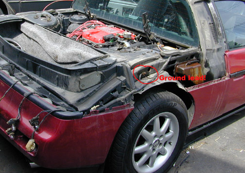

You don't need to do this to your car.... .....pulling out the wheel well liner will suffice.
[This message has been edited by Gall757 (edited 04-10-2020).]
88 cars Do Not have this ground.

So where is the frame ground located for the brake lights on an 88?
