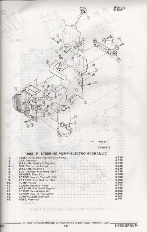

my 1988 Mara has a slight leak at the top of the steering rack. I didn't think much of it until it sat for a month and when I went to drive it, it was almost out of PS fluid.
Is this a common problem? Can the rack be rebuilt?

Fieros don't have power steering, unless someone added it or you have one of the prototype electrohydraulic power steering racks.
Where is your power steering reservoir? Is it near the driver's side headlight?
In that case you have one of a handful of 88 Fieros that got out before the car was cancelled.

To help correctly identify the Power Steering unit, I am posting photos of my unassembled EHPS components.
To me, it INDEED looks like you have a factory 88 Fiero power steering system.
To get the rack rebuilt, you'll need to find a competent rebuilder as there is no "88 rack rebuild kit".
But he should be able to source any seals needed after measuring them.
I would think the parts may be the same as a Chevette PS rack because the
Fiero steering racks were basically a wider version of those on the Chevette.
This is a Chevette PS rack in a Lambo kit.
NO 88 Fiero power steering parts are available
That power steering rack looks very similar to mine (haven't had a chance to crawl under the car). My Fiero is a 1988 Mera with factory (co I'm told) PS. The car has a Northstar V8 and PS pump in on the motor.
Any chance you can get a closer picture of the center part of rack at T location both sides? Mine leaks from top so I can't see where.
Dr Xtreme
Nelson

Report this Post06-13-2020 12:45 PM Click Here to See the Profile for hnthompsSend a Private Message to hnthompsEdit/Delete MessageReply w/QuoteDirect Link to This Post
I will try to dig the rack out of storage and take a few photos this weekend.
Nelson
bjc 350
Posts: 969
From: Astoria
Registered: Oct 2005
Report this Post06-13-2020 04:02 PM Click Here to See the Profile for bjc 350Send a Private Message to bjc 350Edit/Delete MessageReply w/QuoteDirect Link to This Post
The rack Nelson is showing is the proposed 88 power steering unit which was electric. It did not use a pump mounted to the engine. So, you likely have an aftermarket setup.
