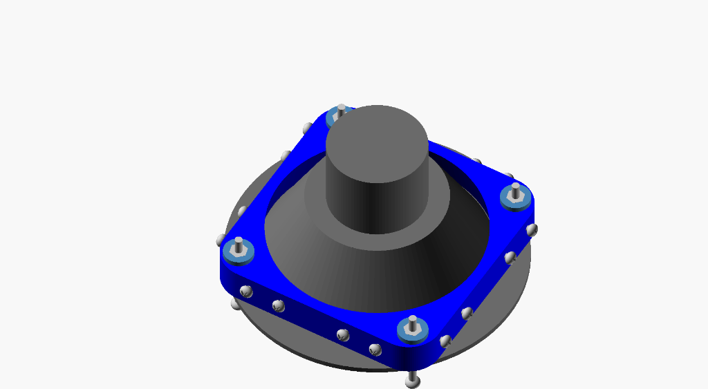

Bit ahead of myself there showing the adapter, more to come later. The Parts Express web page has a very nice PDF with dimensions (with tolerances even!) for the speaker, so I was able to model the thing before it even arrived. Here's the basic idea, drawn up in OpenSCAD
Cut the thing down the middle for better viewing and to make sure the woofer won't hit the inside of the grille.
I find it handy to do up not just the piece(s) to be printed, but the piece(s) that they interact with, so I can check for fitment virtually. Obviously the enclosure is a ridiculously complicated shape, but we don't actually need to model the whole thing, just the bottom coupla inches where the woofer goes. That's the pink-purplish outer box.
Inside that, the blue part, goes the mounting plate or adapter, which is the bit you'd usually make out of MDF. The magic of printing means we can do some clever tricks like make hexes on top for captive nuts:
The nuts are a press fit into the hexes, you draw them in with the bolt, but I also put a coupla dabs of CA glue in there to keep the little boogers in place for assembly.
Hard to see, but the center bore is actually slightly conical to give a bit more thickness at the centers. The outer set of little holes around the edge match the original mounting holes, and the inner set gives extra mounting strength, #6 sheetmetal screws.
The woofer mounts to the adapter with #8x2" bolts:
and then the nuts go into those hexes underneath (err, on top, since the woofer mounts upside down.)
