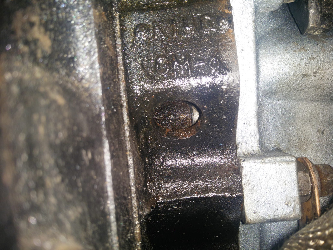

i have diagnosed my faulty temperature gage as being the sender. So i bot a new one. Looked exactly the same as the old one. i tried to quickly put the new sensor in the hole of the old one and it seemed to slip down into the motor. i put my finger into the hole and something appeared to move inside. So i tried the old one to see if it would drop down into the hole as well. And sure enuf it started to go down into the hole. What is going on here? What am i missing? Is there an inspection port for the flywheel that i dropped my sensor into?
So i used my flash on my phone to take a pic of the hole.
jon

Sure enuf, there are two holes. Where did my temp sensor go? Down into the clutch flywheel area? Any ideas?
jon

Yep. Pull the inspection plate/starter and see if you can fish it out. An extending magnet might help. but I am not sure the sender is made of steel. Brass isn't magnetic.

Great idea. With the inspection plate and starter removed (disconnect battery first!!!) a flex magnetic pick up tool may work. That's a magnet on a long flexible rod. I believe the sensor base is steel so it should work. . With a bit of luck it may come out. Might also try rotating the engine slowly by hand using a wrench, small prybar or big screwdriver on the flywheel teeth. Sorry to hear about the mistake but we all make them.

The sender is not magnetic. Some have suggested using hot melt glue on a stick. i managed to move it using a bent wire. Didn't spend much time trying. Gonna try more tomorrow. Jelly2M8 sent me some pics of a spare motor he has and it appears that there is no way for the sender to fall down to the bottom where i can fish it out by removing the dust cover. Sooooo i have been looking for my hemostats.

I think all 3800s have that hole.
I know mine does but the sender doesn`t go there.
It goes right under the thermostat housing.

My eyesight isn't what it use to be but that hole appears oval in shape and thread-less as well. I've got to be missing something, right?
If you can't get it fished out perhaps leave it there. Squeeze a little high temp J-B Weld on it to keep it from rolling around and call it a lesson learned.

Originally posted by Spoon:My eyesight isn't what it use to be but that hole appears oval in shape and thread-less as well. I've got to be missing something, right?
The hole is round, and is indeed threadless. Why is it there? Dunno, but it trapped me. i wud never consider leaving it there. i spent 1200 canuckbucks on my flywheel, machining and clutch, and bolts. Allowing a 40$C sensor to damage them is a no go.
i have now separated the block from the tranny by about 1cm (3/8") and still cannot see the sensor. My wife claims she can feel it. So i will let it sit for a while to let her try again. The block and tranny are being held in alignment by 5 long bolts. It took me 7 hours to drop the cradle and slide it out to the side, including over an hour to get the front cradle bolts out. I have no rust on my car. It will probably be 12 hours or more to reinstall the cradle and hook everything up.

i separated the trans from the engine by about 1/2" My wife managed to loop a wire around it and we tightened the loop and worked the sensor out using the wire and a rod.
