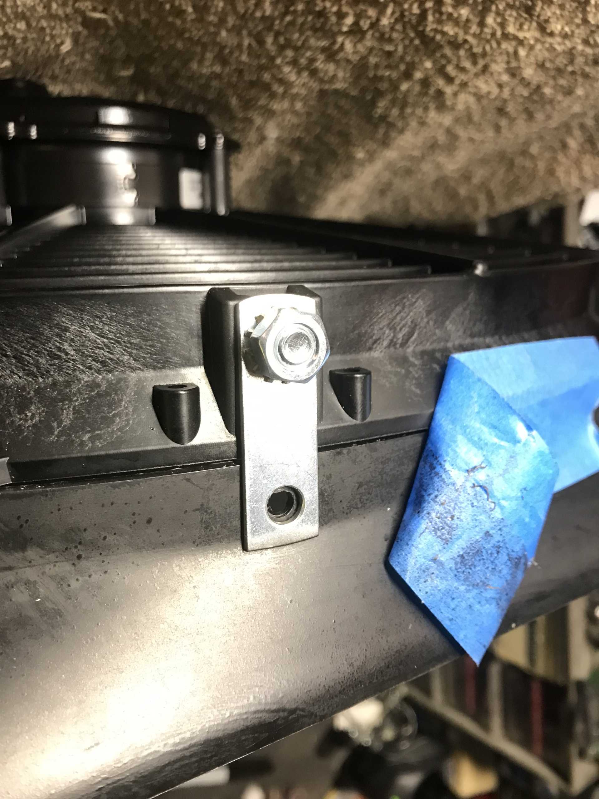

I just thought I would post my electric fan upgrade project here.
I have been wanting to upgrade my electric fan in my 85 GT for a while. My desire is to lower operating temps by a good 10 degrees if possible.
I haven’t done a huge amount of research but I have learned that it pays to get a SPAL electric fan.
So, at this point I have removed the factory fan:motor assembly, I have received the new SPAL fan and am now waiting for the 4 clips/brackets to mount the new fan to the factory shroud.
See pics of the factory shroud/ fan assembly and also the “S” blade side of the new SPAL
fan.

I mount the new fan to the inside of the factory shroud after the OEM fan mounting "cross" is trimmed off.
Some shaping of the new fan outer ring to remove any protrusions and the rivet the two pieces together in six places.
BTW, a new fan won't lower the operating temperature, that is controlled by the thermostat.

One thing not mentioned is that the outer plastic ring in my factory fan is out of round and is presently rubbing against the shroud. By accident I had the front end up in the air on jacks abs when I lowered it down I left one of the jack stands under the bottom of the shroud.

Abs here are two views of the L clips that you can order with these SPAL fans.
Not sure if I’m going to use them for this application but I bought them just in case.

On the SPAL fan, if you remove the bosses from the outside of the housing, the fan will fit into the OEM shroud and can be easily riveted I to place.

Ok gentlemen. Project is now done.
Here is what I did:
I pirated the female fan harness plug from the factory fan motor. Yes, I soldered the connections and used heat shrink tubing and high quality black electrical tape to insulate/ seal it.
Then, I needed to go to Home Depot for some various bolts, brackets and shrink tubing

Next, the new fan fit almost perfectly onto the backside edge of the factory shroud. This is where I realized the SPAL “L” brackets I bought were not going to work. They do sell STRAIGHT brackets but I wanted to get the project done. (Sundays are my only real day to work on cars) So, I came up with the idea you see here. You’ll notice I took a package of corner brackets and turned three of them into 6 mini, straight, flat brackets and I also oversized the holes a bit.
If you look closely, you can see that I gave the bolts three flat edges so that the heads would nest down into the square bracket holes in the new fans outer ring.
[This message has been edited by Kitskaboodle (edited 02-06-2022).]

Next, I ran some smaller, countersunk screws from the inside of the fans ring to the other hole in the bracket I made. The next pic shows that only a small portion of the screw head protrudes on the fan / inside area.

This pic (should have shown it earlier) shows how tightly and snugly the new fan sits on top of the factory shroud. Yes, I could have set it further downward into the shroud but this would have been much more work and would not have had such a snug fit/seal.
