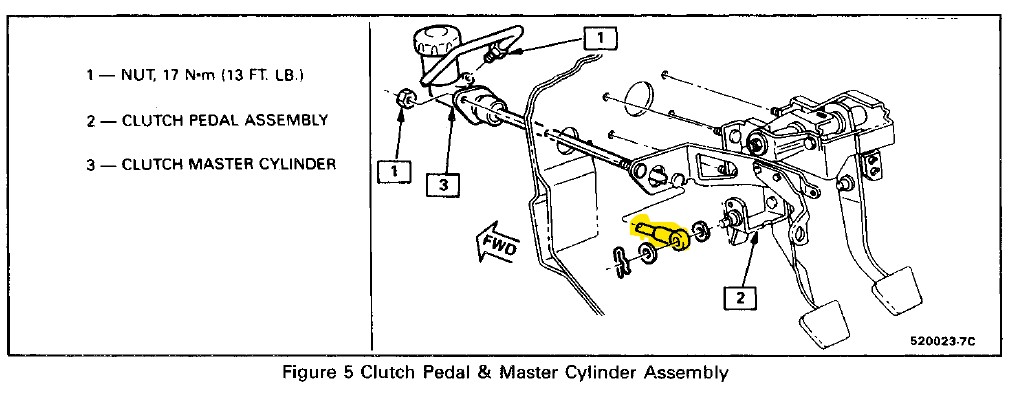

I measured the throw. 23/32 cold, 21/32 warm. There is a 1/16 throw lower when the engine is warm.
I took a close look at my clutch pedal. It is higher than my brake pedal, made of steel and is not bent. It is a little loose mostly due to the slop on the banjo. While I was looking at the banjo I decided to flip it around to see if that would have any effect on the throw. That resulted in a 28/32 (7/8) throw after the engine had cook for about half an hour. That is still longer than it was previously cold. It is no longer grinding.
The next thing I need to look into is replacing the plastic bushing on the banjo. I am not even sure if that is a separate item I can buy. If I could replace that with something much better fitting it would eliminate the wiggle in my clutch pedal.
The loop must go up.
We covered all this in a recent thread.

I ordered a brass bushing from Rodney. I think it is take up the extra play in my pedal.
As for the banjo direction, wouldn't the best geometry be the one with the most travel? My car is 35 years old and I am not the first nor even the third owner. Could it be possible that this perfect geometry with the banjo up no longer applies due to possible frame damage or warping prior to me owning it? On my car, there is 1/4" more travel with the banjo pointed down. It is still short of the 1 1/8" that people say is needed but it is a 1/4" closer. I will measure it again when I get the new bushing.
The 88 service manual show a straight rod. Go figure.

The clutch has about 4k miles on it. I also replace the master cylinder at the same time as I replaced my clutch.
Are you referring to the bushing in the banjo? Didn't your replacement master cylinder come with a new banjo? If so, how did it wear out in 4k miles?
If it was my car, I'd want to find out why my clutch pedal alignment was different than everybody else's!
It's the steel part that bends! How much higher is your clutch pedal than your brake pedal? It's supposed to be an inch.

I don't believe the bushing wore out in 4k miles. I think it was loose when I installed it and I just did not pay attention to it.
I am not sure if my car does have a different geometry. I read through a few threads that mentioned banjo up vs down. The best reference I saw was someone quoted Archie. I did not see anyone actually measure the difference. I measured the difference and based on that I will have my banjo down until I get the new bushing at which time I will measure it again. Even if my car has a slightly different geometry, I have neither the time nor patience to try to figure out what the proper dimensions of the structural members are on my car and whether my car falls into factory specs.
That U piece of my clutch pedal is straight. I measured the top of the U and the bottom and they were the same. The bottom is at a 90 degree angle to the part of the clutch pedal it is attached.
There are two different size banjo bushing/pedal assemblies. Perhaps you had them mismatched.
I've noticed on my Fieros that if the banjo loop was down, the angle of the banjo in relation to the master cylinder was **** -eyed when the pedal was pushed to the floor. Not so with the loop facing up. Anyway, do what works for you.

Interesting observation. While I've always heard the banjo loop needs to be up, I've never actually heard of anyone that measured throw with it up vs down before. I'd like to hear from anyone else that has measured both ways and what the measurements were.

The effective length of the banjo pushrod is measured from the banjo hole to the spherical (or is it conical) tip which pushes on the master cylinder.
This effective length remains the same whether the banjo is up or down. (No effect on throw)
With the correct banjo orientation, the rod remains better-aligned within the bore of the master cylinder. So, the rubber sealing boot works better, and there is perhaps less risk of the banjo rod scratching the inside the master cylinder.
