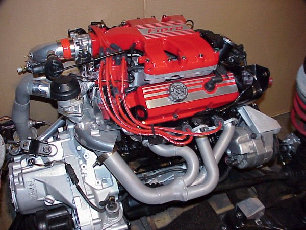

FWIW, these manifolds were painted with VHT exhaust paint from Orielly's.
I applied it in March of 2019, following the instructions as closely as possible, and cured them in an oven. The truck has been driven tens of thousands of miles, literally across the country, it's been to Alaska, Key West, and almost everywhere in between, I also didn't have access to a sand blaster to get them really clean first, just wire brushes. all weather, rain, snow, sun, you name it. it's been on salted roads, and even spent the night at Bonneville once. it is worth mentioning though, it's a suburban with a TBI 350, Maybe if I'm lucky it makes 200 hp. your results may vary, but I'm pretty happy with mine.
here's a shot of some of the road trip miles it's been on. it's also served DD duty several times, it's ever faithful.
