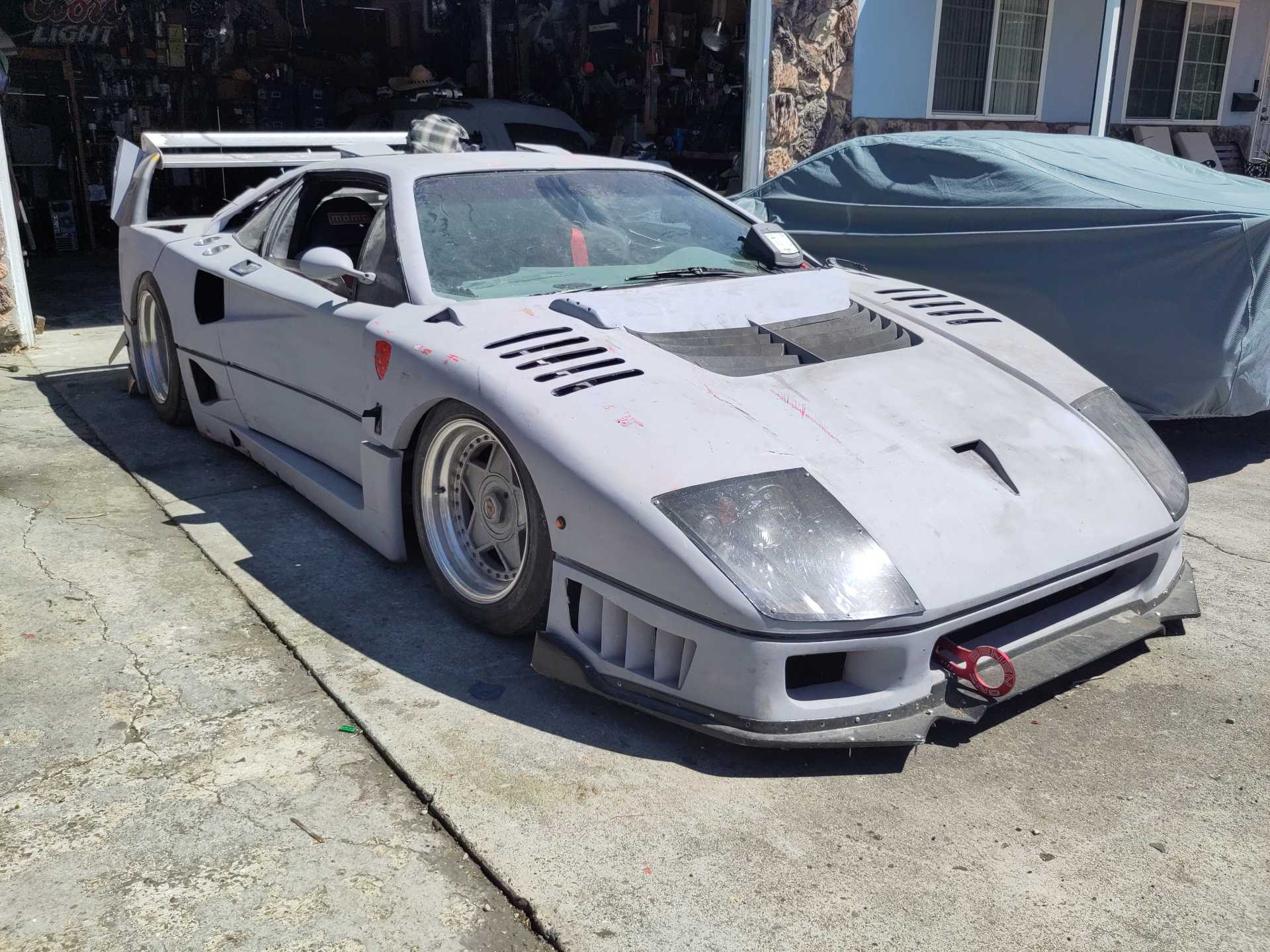

Finally got to pulling the car out and doing a little work. Fired right up and everything working. Good thing I labeled the switches lol. The hood scoops scoop didnt have a nice edge where it touched the hood vent. The voices said to elongate the front and taper in the sides. Worked out good
Just need to finish that up, did a lil work on finishing the roof scoop also. . Got on my cuz to finish the upper wing of the rear spoiler, hopefully that gets done soon. One of my customers has a print shop, and hes making decals for my hood emblems. Didnt know what to put on them, so I went w the family crest. Burned thru a ton of projects so the car will be getting love again soon.
Almost done w my beater trucks paint job, got a new front bumper, lower valence that I added a lip and lights to, and put a 4runner grille on it
Figured out my issue w my devilbiss paint guns lol, theyre junk. Watched a youtube video of a pro trying to use them and out of the box and after several cleanings, even he couldnt get them to spray good. So I got a new gun, the new hf "black widow" hte gun. This things bad arse! Lays down pant like butter perfectly wow luv it!
Painted my wifes friends destroyed honda. No joke 3/8" of bondo on the drivers door
There musta been 3 cans of bondo on that door, last goober didnt even try to pull the dents out. In 15 mins I had the door pulled out where it only needed an1/8 of mud lol.
Did this and my truck in the duplicolor lacquer they sell at kragens. Nice paint dries quick. Dont bother w the lacquer clear tho. I had just shot 2 coats of clear on this car when my cuz came over. First words out of his mouth," whens the clear going on?" Itll be getting a urethane clear on top. Came out perfect tho
And I knocked off a bucket list item, an arcade machine. Didnt want one w one game and always wanted to build my own. Was in a best buy and saw the arcade 1up machines and they look lame! Got this konami box from cl for$200
Got a 22" monitor, some usb encoders, and the buttons/sticks, loaded all my goodies on an old asus laptop, made a mount for the screen and controls, swapped the front doors over and
6300something arcade games on mame(1400 not working, 8k total) every american and japanese console game for the nes, snes, n64, master system, genesis, segacd, turbografix16, neo geo, and probably more on their own loaders.
Concrete pad for the new garage/shop going in friday hopefully!

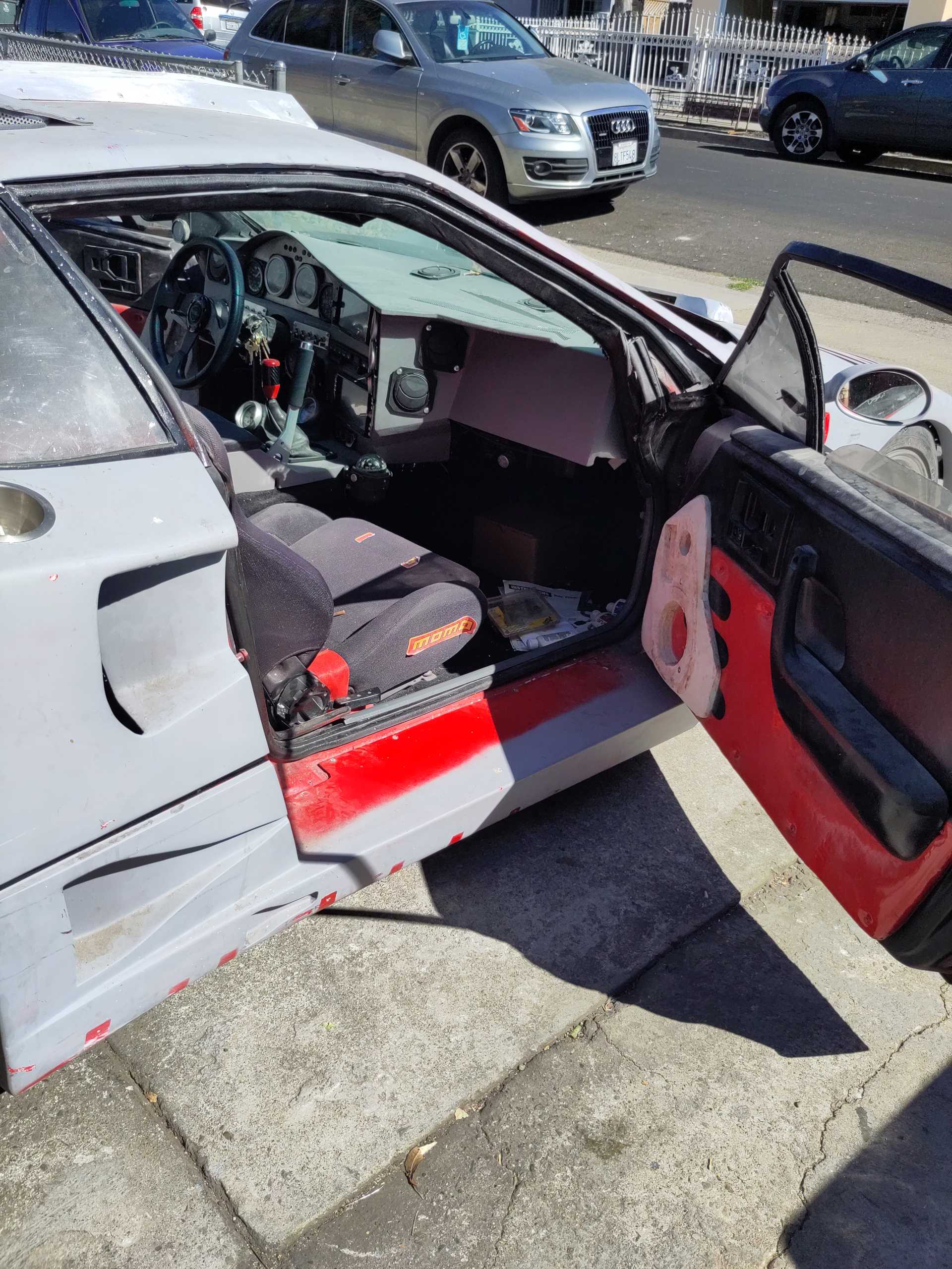

I never give up, just get sidetracked! Im a dad and works picked up bigtime. Havent really done much on the car,told myself id get the dmv stuff done before any more work. I got my dmv guy to speak to the manager of the local dmv and she doesnt know anything about it. Called the smog ref, they were very helpful but need that certificate to start the exemption process. May have to drive to dmv headquarters and do it myself.

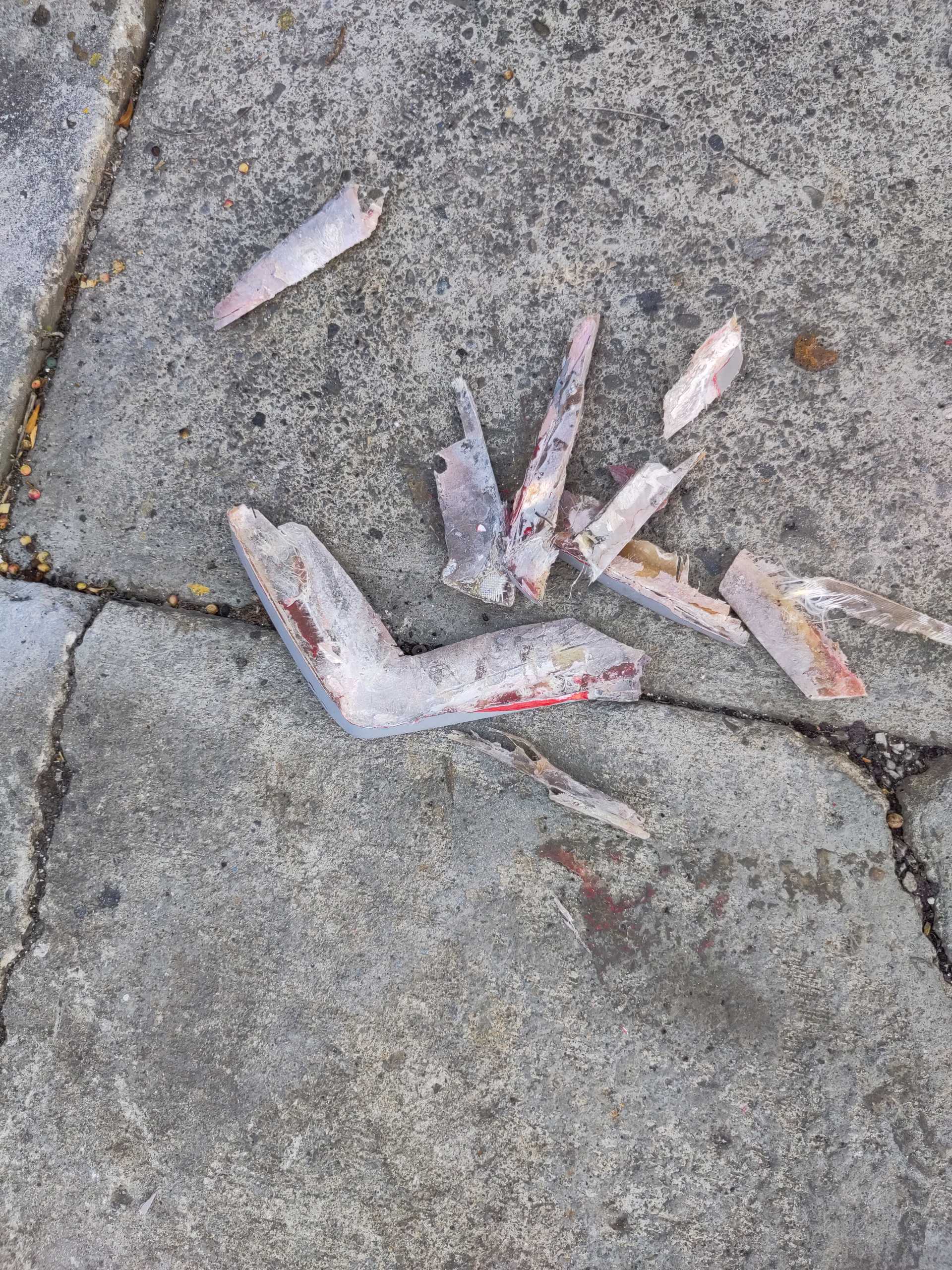

Got my side emblems made, a new tail light, and fixed up a buncha small leaks on the air ride. The engine belt would squeal sometimes, especially when revved, so today I moved the tensioner over to the udder side like I did w my other motor.
Got a 74" belt and fired it up, no squeal at all. Even backed into my garage and came screaming out into the driveway in 1st and no slippage. Locked up the front tho lol.

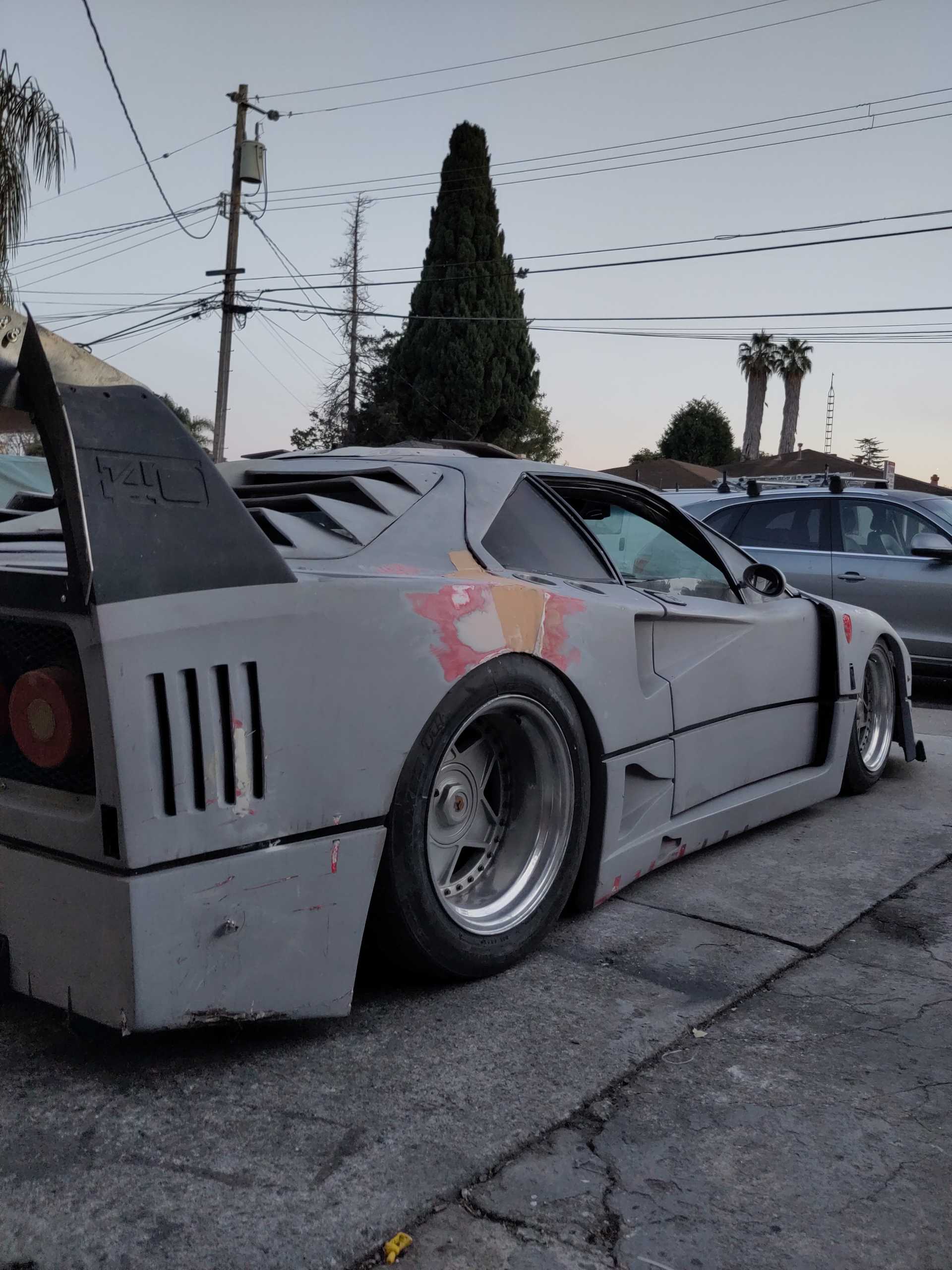

Then I trimmed up the hood scoop scoop and cut the holes for the vent screens
Cuz welded the upper spoiler but its a bit short. Painted my beater again and got decals
Picked out indigo blue for the color. A beautiful dark blue w just a tinge of purple. That chits purple, I really didnt want a purple truck fock! It gets tons of compliments tho. When I ask people what color it is they all say blue wtf?!
Neighbor 2 doors down got her boyfriend to move in from east coast. Very cool cat and into old cars. Took our rides out for a cruise
Crazy cart xl are all sold out, and I wouldnt pay a grand anyways- so I built my own called the silly cart. Made it from a pocket rocket so the fork assy only lets you drift up to 90 degrees. Another in the works from a scooter w 360 rotation. Ill make a post in ot about it because this is something everyone needs to have and at least try. The guys at taxi garage sell them if you wanna pay 3k for a custom one. The deere one on their website looks awesome
https://www.youtube.com/watch?v=81HfOW9TLI0&t=552s
Made mine w the fairing and seat from the bike and was going to put the old fubabbi wheel on. My cuz had this old yacht steering wheel he was going to toss ages ago, I kept it and put it on because it looks hilarious, out of place, and makes you feel like your driving a school bus lol. Got a free skateboard and wheels and modified some casters to fit the wheels. Used an old section of 3/4 gas pipe from a job, an exhaust coupling, a pvc spacer, and a broken off post hole digger handle for the drift bar. made the frame from emt and covered it in some diamond plate. 36v battery, controller, and pedal, and off to the races. Guaranteed smiles and fun for hours!

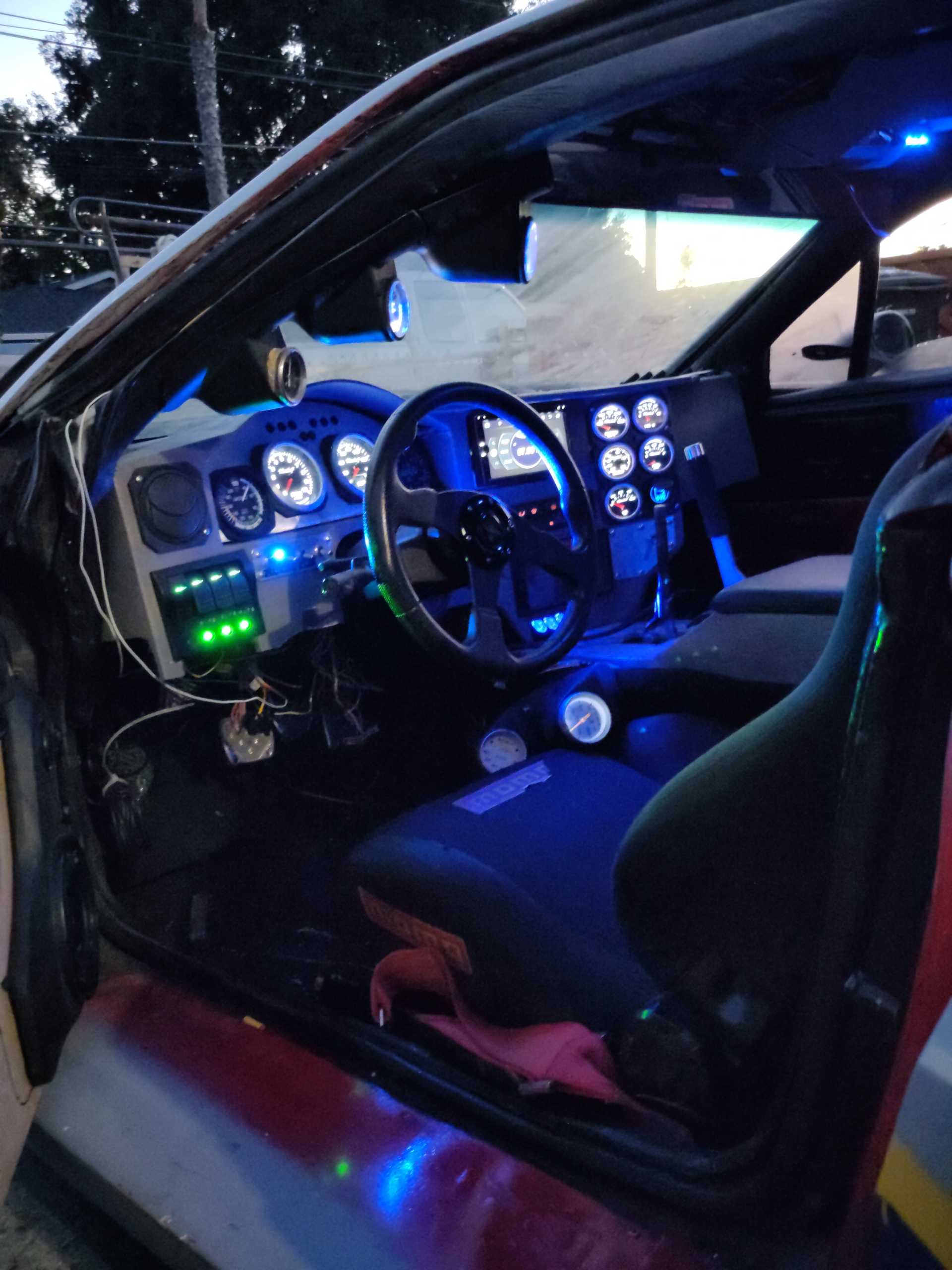

Started hunting for leaks and got the gauges installed
Pulled the remaining wiring from yellow and swapped over, tried to take a pic of the gauges activated, but the displays wont show in the pic

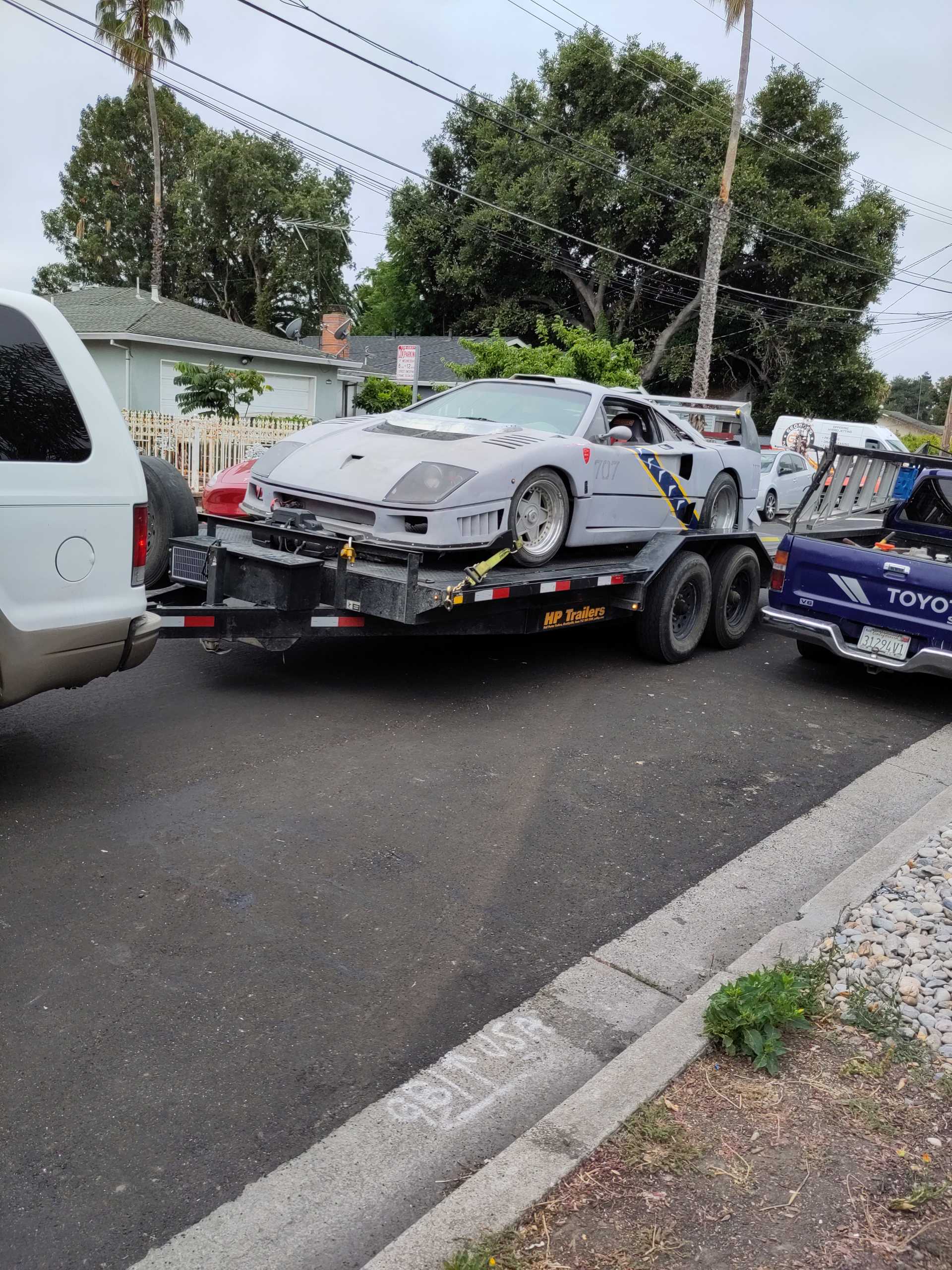

Then I had the bright idea to hire a tow truck to take the car to chp for the vin verification lol duh. Lined a guy up and asked chp for something the week of the 11th, and the guy says their next appt is sept 23rd. Well fock lol. Declined and told the tow gut id shop around for a sooner time. Chp nearest to me wont call back or answer, and the independent verifiers cant do kit and salvage rides. Resigned to my fate I called chp back to take that appt. Another guy answered and gave me an appt for 8/12 lol. All set up to wrap this chit up!

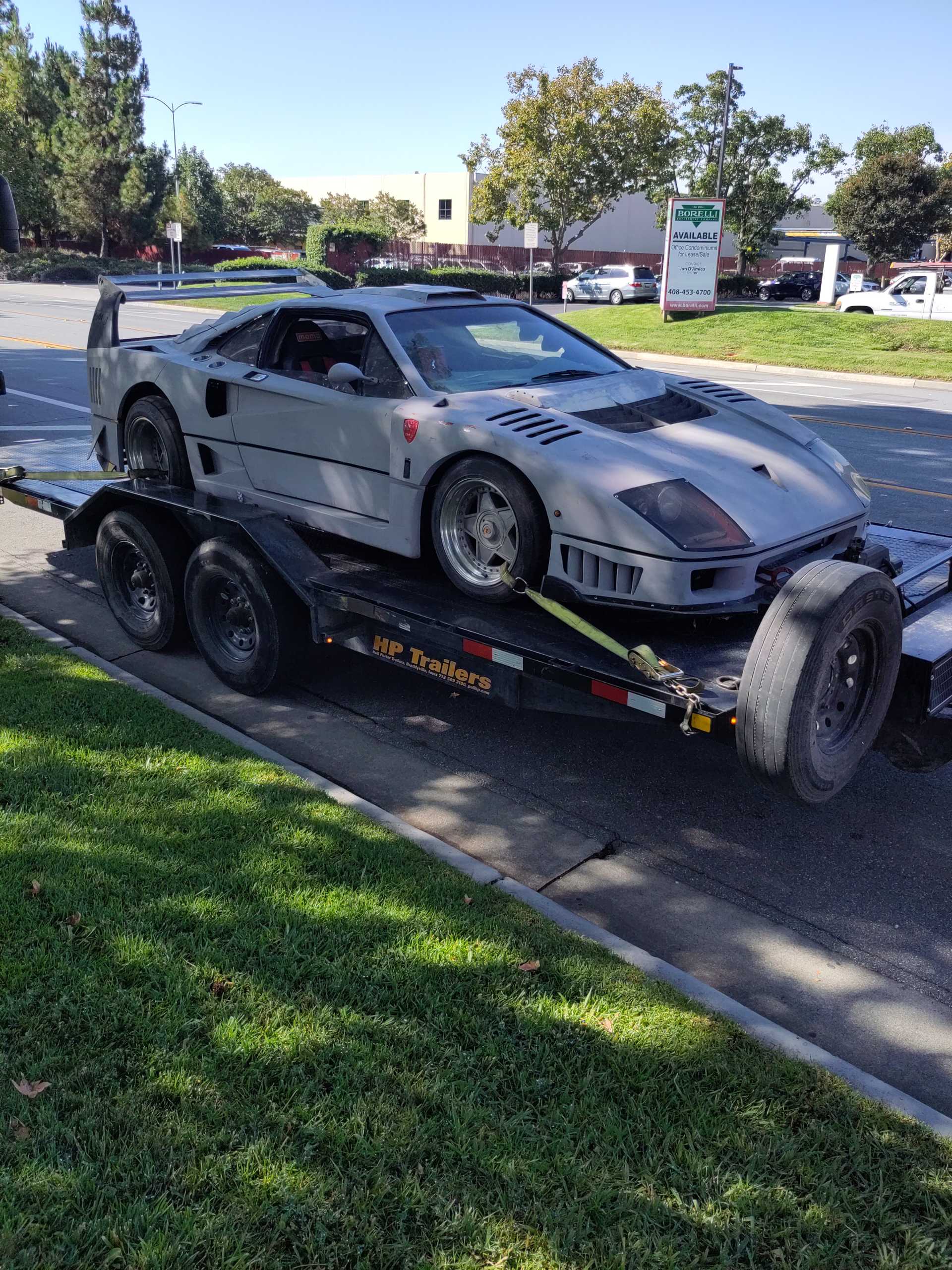

Thank you Mr Sage, slowly but surely getting there. Very slowly! Took it down to chp for the vin inspection before I got swamped w a ton of work. Hired a guy w a trailer that does it for a living, easy peasy.
Got it signed off then emailed a copy to the special dmv unit. Got a lil attitude n some runaround just to find out I now need a brake and light inspection. So I had to tackle the ebrake, it always gave me crap and I could never figure it out years ago. I put new rear calipers on sometime ago, and left it at that. Read up on some ebrake threads, got nothin lol. All I got was remove the whole lever, and hold the brake pedal and pull and it should self tighten. I put the cables in the calipers and set the springs, then saw I needed the clip that holds the big cable to the right side. Remembered I have a loaded cradle, one was there. Got that all together and pulled the ebrake, someone dripped fiberglass and the buttons glued to the handle lol. Looks like its been there a long time. Remembered I got a newish ebrake from a guy thrown in w some udder parts I was getting. Installed it, adjusted the equalizer thingie until the bolt holes lined up for the ebrake, bolted it in, put one hand on the brake pedal and pulled w my other hand. Click click click click. No way couldnt be that easy. Tried to move the car, chits locked up tight. Then I went thru some hassle but the turn signals and hazards all work now, minus one side marker that needs to be swapped out. Doing the high beams to a switch, cant find the switched high beam wire from the signal harness. Gotta check the wipers too, was fiddlin around and the horn went off n spooked me good while I was working in the footwell. I didnt even think I hooked that up lmao, got me good.

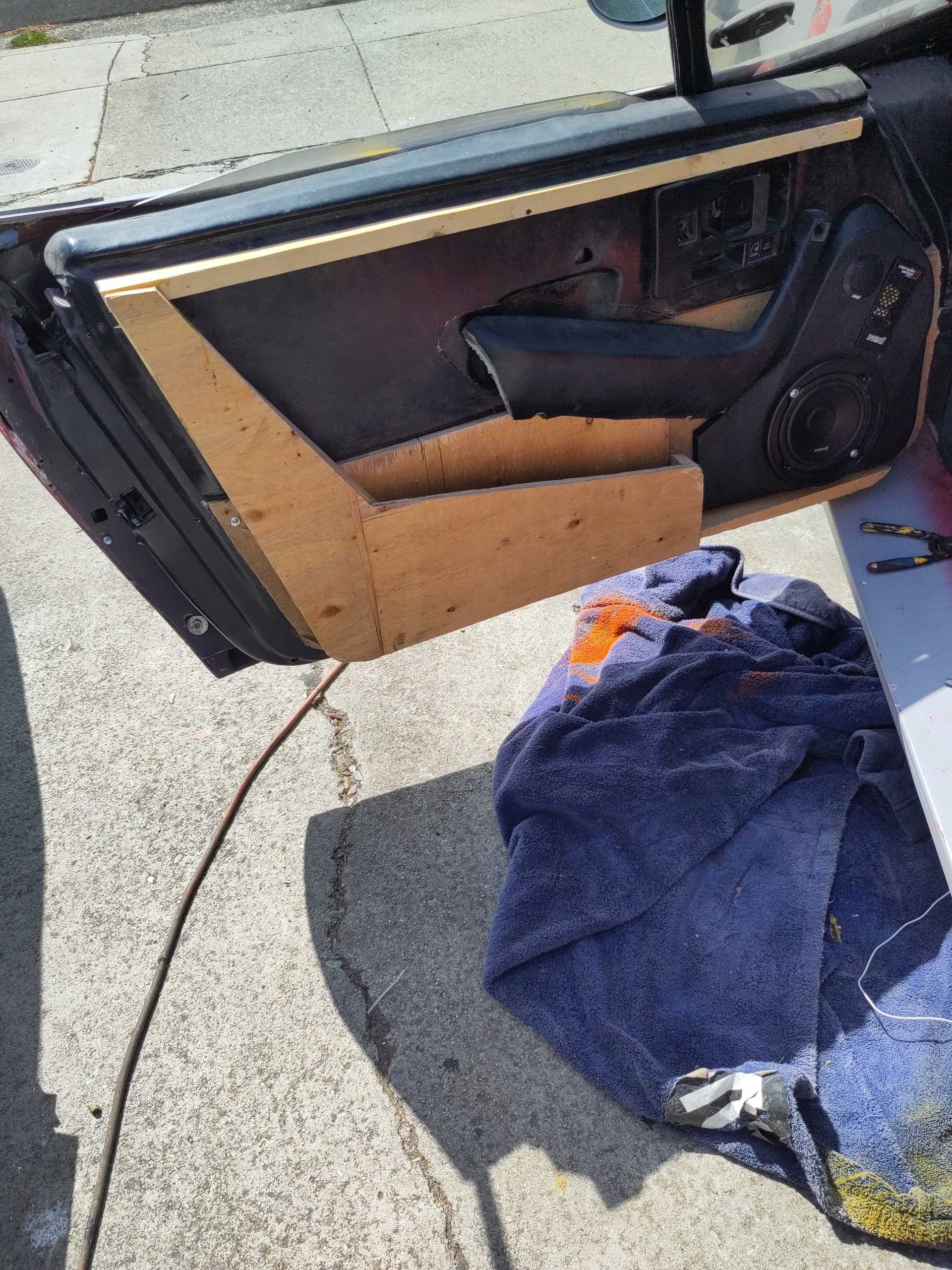

The little door speaker pod turned into a door panel idear, gonna be something like this.
Its too fat in the rear and hits the spring cover for the seat even after I trimmed it. Prolly gonna foam n glass it sometime in the near future, def looking forward to hearing some tunes. Dug out an old amp to power the sub. Super nintendo was in the same box so I started playing mario world w the kid. Hes already over it but loves fishing now. The punch/detail list is long, and constantly getting added/subtracted to. Shakedown cruise in the near future

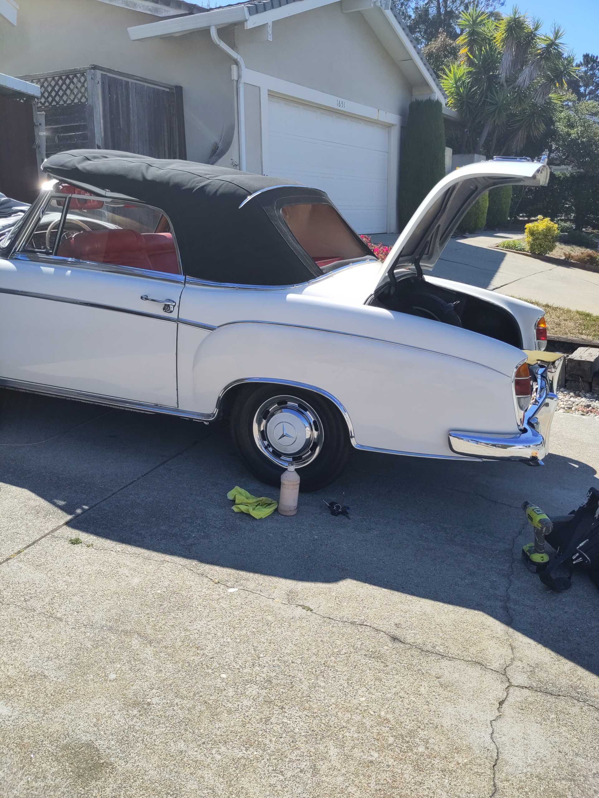

Some of the work I got was swapping out the front harness and headlight motors on an 86 to the later style. That evolved into some other things, then onto the 58 220 convertible

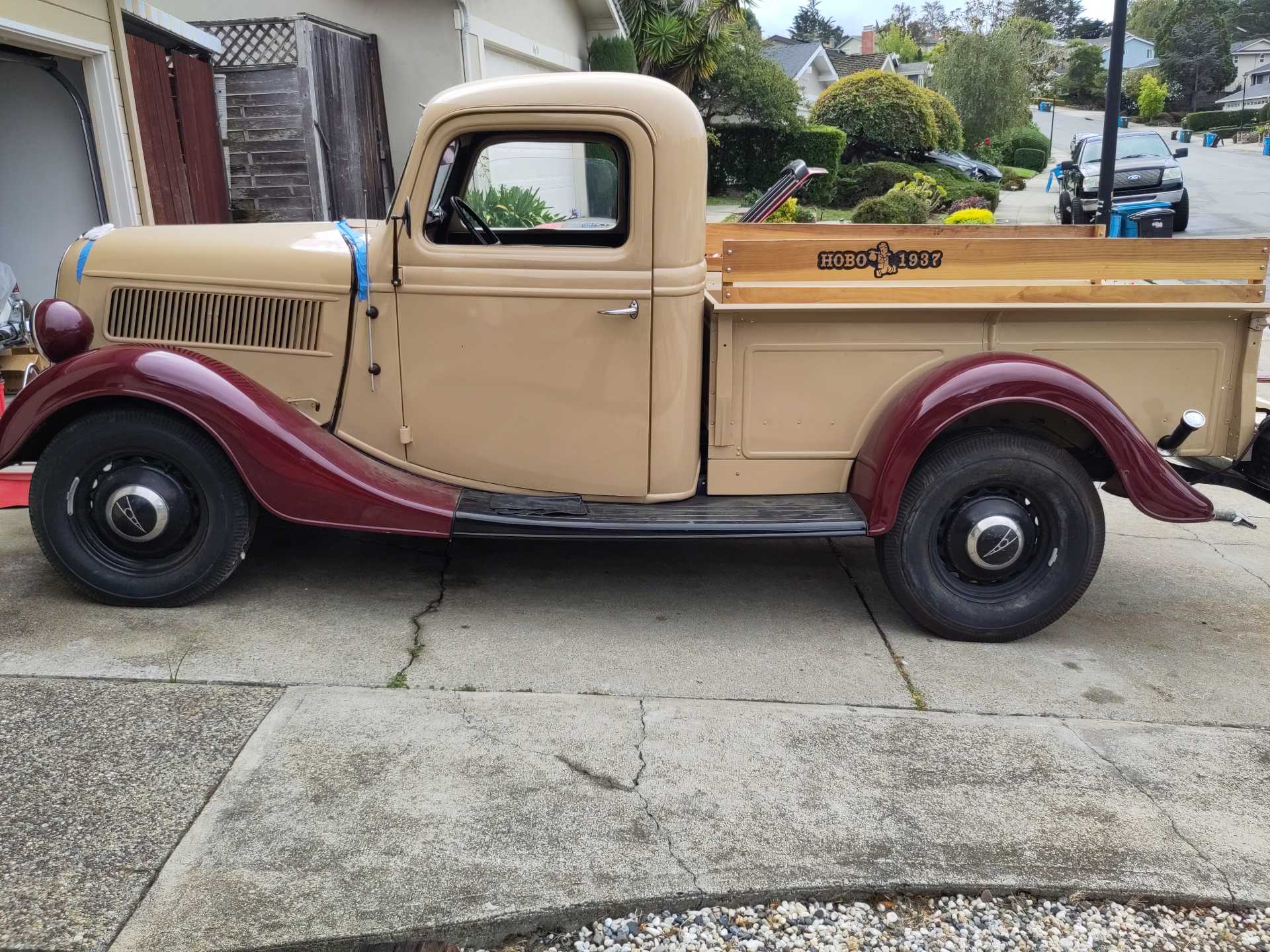

Then the 37 ford

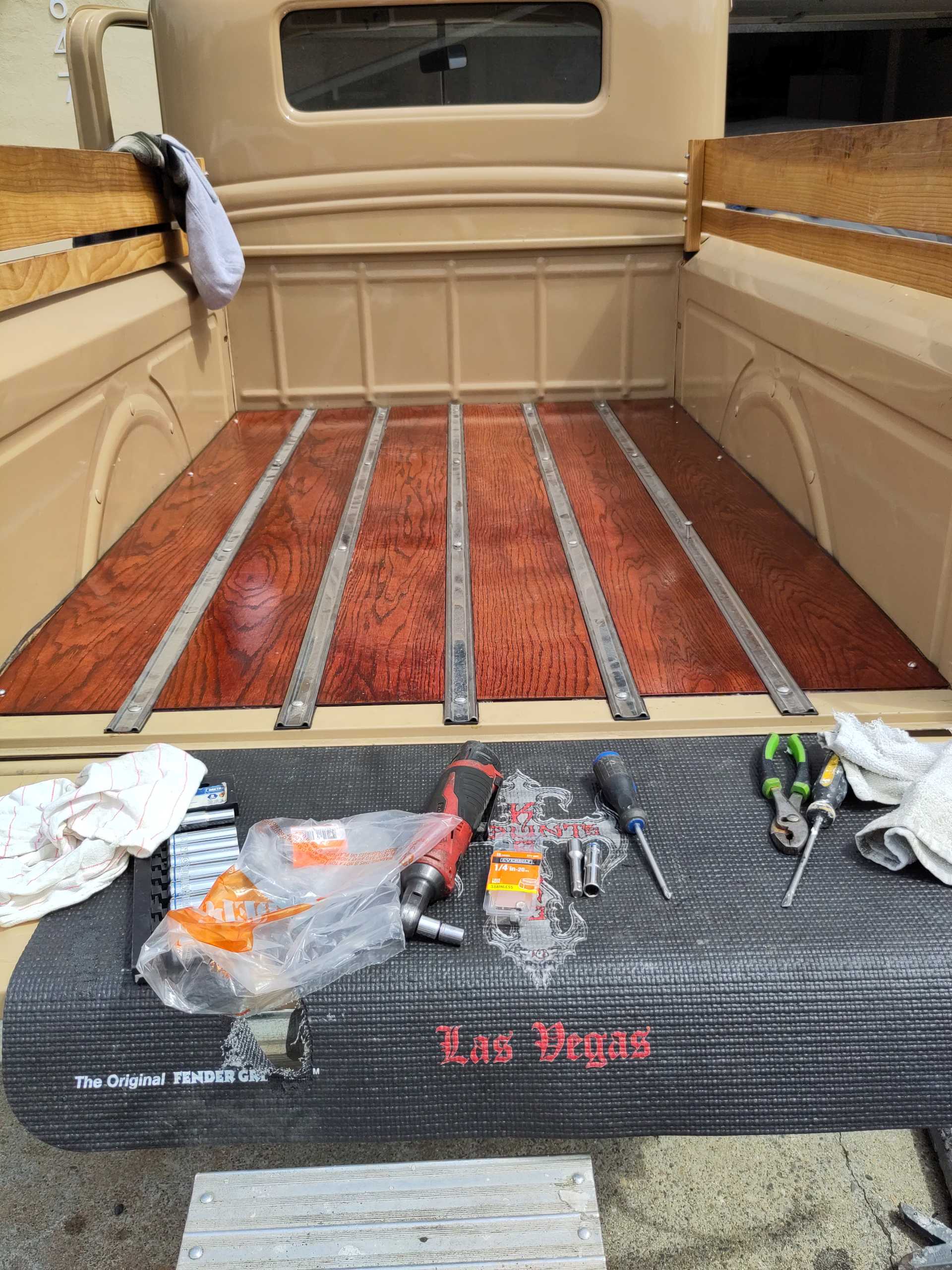

Hood adjustment (PITA), install gauges, redid the bed boards in red oak and lotsa coats of old school lacquer. He loved it

Lights dont show up good in the pics, but look sick af in person

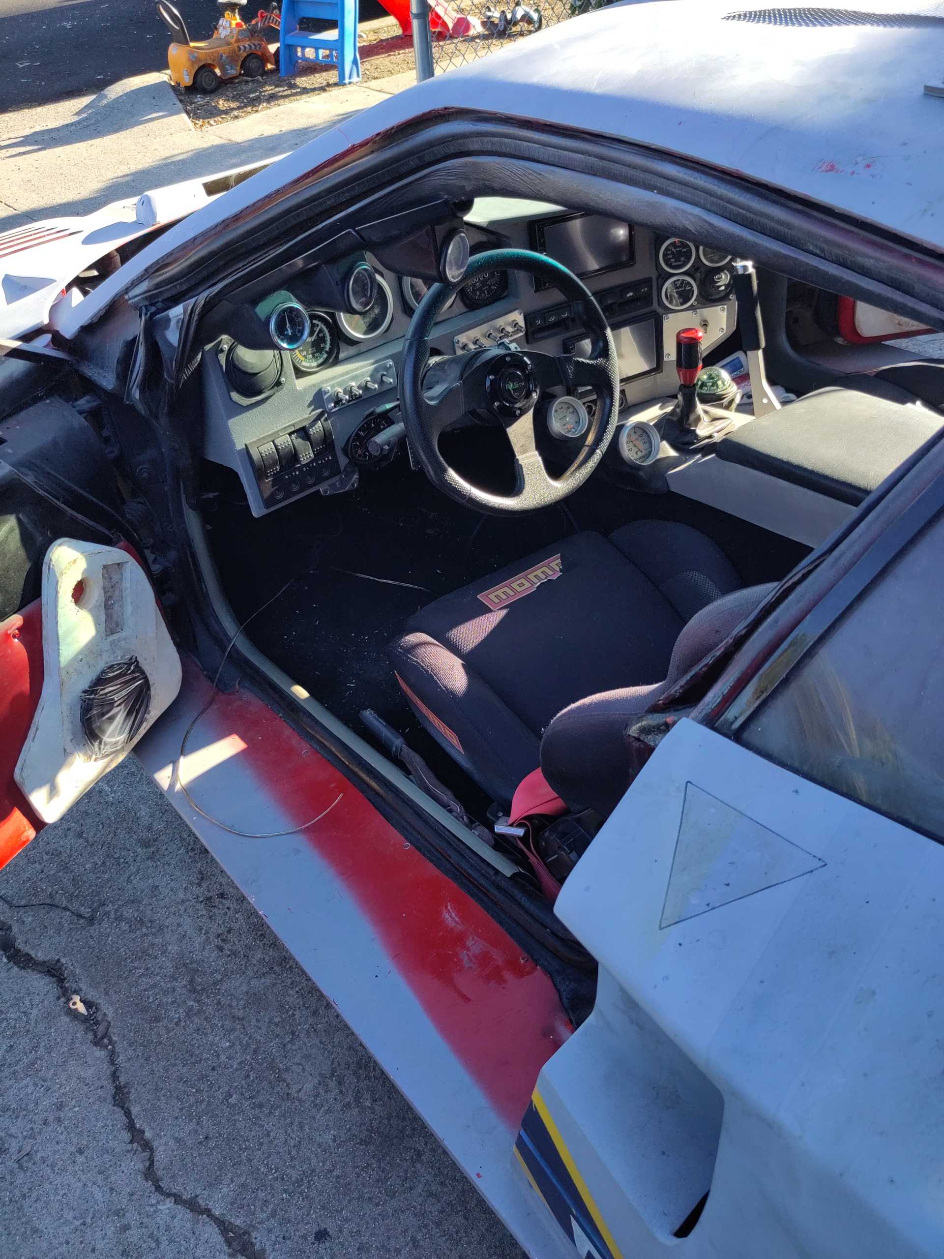

Ive been busy on this, and have many more idears in me noggin. Finished up the glasswork on the roof scoop and hood scoop scoop. Ground down the welds and got the rear wing ready for primer. Wrapped the exhaust in that fiberglass tape I bought years ago, lol priorities. Pulled the rear bumper and made the lower wings and diffuser tips outta glass, lower wing tips touch the ground when slammed. Got side skirts on the way, rear louvers are glassed on the underside now too. Bottom section broke off, so that got beefed up on both sides. Still got finishin to do on that.
Also got my side mirror situation figured out, found some universal pwc mirrors. Looks good and provides much more vision than the vitalonis. Moved them as far back as possible on the window, only a teeny bit is covered from the passenger side. Ordered them about 5 times, I kept getting right hand mirrors sent regardless of part number. Finally got a drivers side one the udder day, ones white and ones black.
Finished up the quarter panel to hatch areas, and the gap is nice and toight! So now the roof to hatch gap is unbearable at about 5/sixteenfs- so Ima glass it back together and cut the line, again lol. Hopefully for the last time. Finished up the rear camera mounting and wired it to a switch. Put insurance on it and found a shop to do the brake and light inspection. Gonna take it for a shakedown cruise sometime next week before taking it to the inspection.
Got a crazy idea to find a stock windshield and frame that i can graft in. The windshield I had cut down has cracked already, and I dunno if that shop would cut down another one for me. Dont really want it since this ones cracked from not driving the car lol. Im sure itd be much more pricey now. Rear struts hold air for weeks without leaking, but the 90 degree swivel fitting I have on the front bags just keep fighting me. They only hold for a few hours, so I need straight fittings then elbows to the mani. Drivers side wheels valve stem always randomly leaked, so I got new stems n tires for the front. Nitpickin on details now, buncha more minor things I dont remember. Just getting over the flu.
Need to install the front shocks but have to make some custom bracketry. I have to cut the shock pocket off the lower control arm, and I have a chunka hunka 3/16 square tube the new shock bottoms fit into that ill weld to the side of the lca and box in the bottom.
Redid the fuel filler lines and routing w new rubbers so its well off the tire when slammed.
Close is the day where I can post pics of my car thats not my driveway lmao

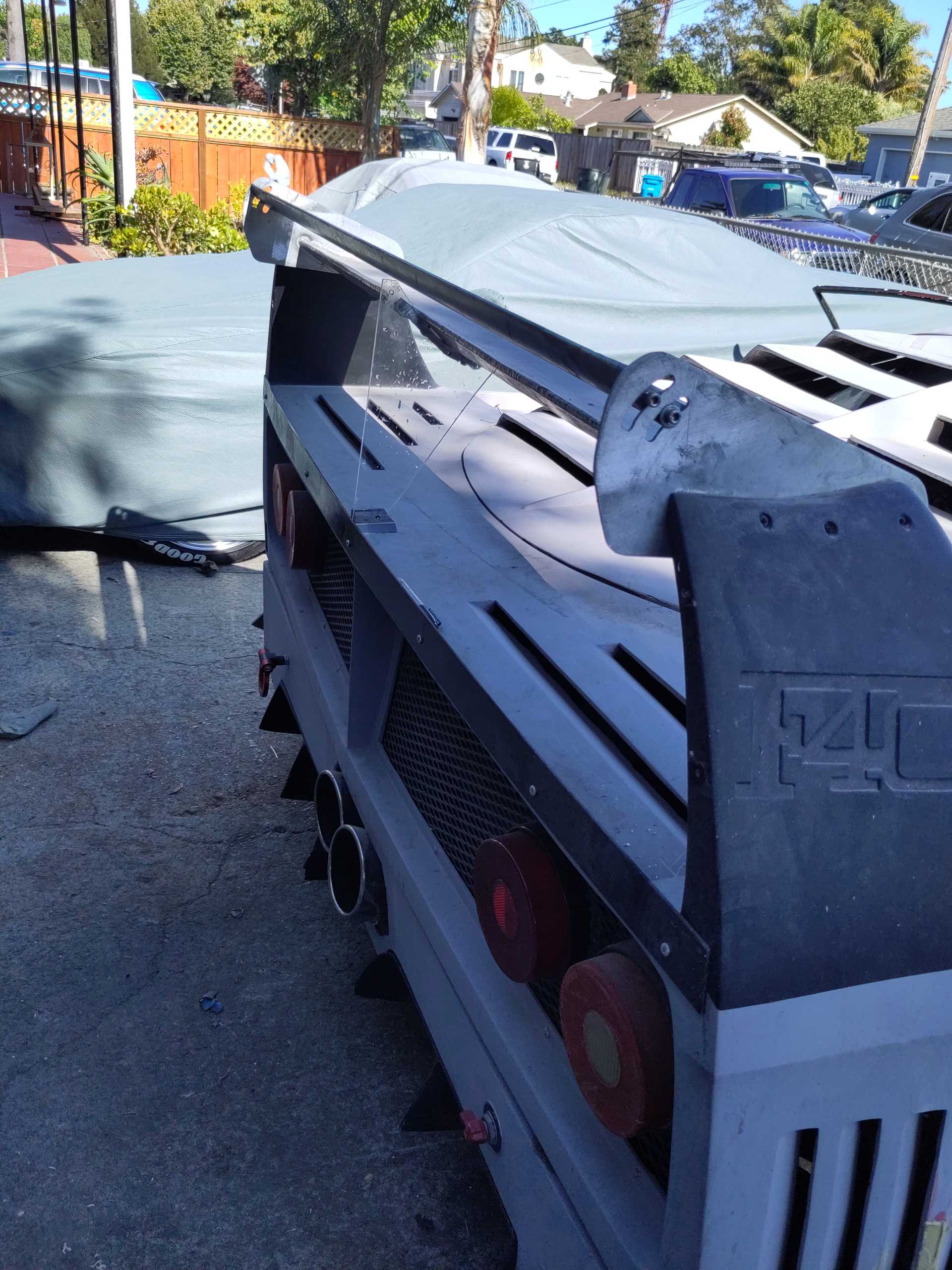

Busy bee is making lotsa progress, just not much on the kit car lol. Glassed the roof and rear hatch together to make the line thinner than the almost 3/8" it was
Cut it w a cutoff wheel and jigsaw, had a 1/8" gap and it looked good. Opened and closed the hatch once, the gap settled 1/4" lol. Drilled and glassed in some bolts at the rear legs of the roof so it bolts to the quarters. Lotsa spot filling and going over the edges of all the panels. rear hatch is soaking up my time. Did get the car a fat coat of primer yesterday and its looking good. Repainting everything, even the window frames, cars all stripped down. Few more spots to fill and go over w 400 and its painting time.
A customer called me all bummed his foot slipped off the brake and he rear ended someone in his fiero. I cheered him up by telling him I have a bumper and the paint.
Had to paint the rockers, couldnt find a matching color to the black. Saw the faintest hint of silver at the edges of the rockers ends inside the wheel well, he said go for it. I had some silver left over at home from anudder paint job
He aint sad no mo! lol Paint laid down super flat
Then my stepson smashed up his honda....
framerails were bent in a lil bit and the reinforcement bar bolt holes wouldnt line up. Fiero jack and 2x4s to the rescue. Did everything but the hood, black paint came out perfect
Doing a lot of painting lately......
shem

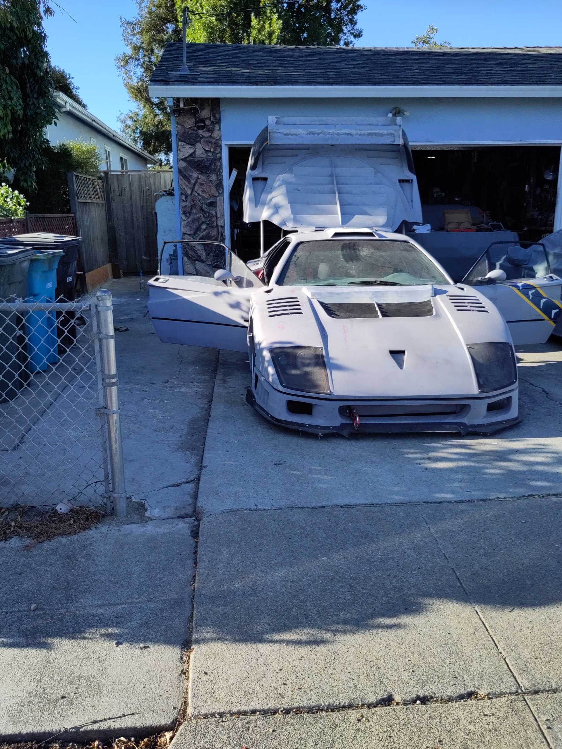

Projects keep coming, city didnt like the red fiero parked on the front gravel area so I installed flagstone. Trans went out in the toyota 120 miles from home, Got a tacoma v6 and trans to swap in. Did throw some paint on the car yesterday, a bastardized quick spray. I really wanted to see the color and some gloss before final sanding. Love the color, its a very dark grey. Almost looks black in the sunlight at some angles. Definitely happy w the color
Now I can final sand, hopefully get it all done next week.
How many times have I said that before lmao

Spent more time chasing overspray on the body lines, then it got up in the 80s quick. By the time I got to clear, the body was too hot to keep a wet edge even w the slow activator. Good enuf, needs to be buffed out. Or cleared again when its cooler but its all one color and very very shiny.
Then I have a bunch of assembly to do, parts to put back but ill be venturing into this toyota swap for my pickup for a bit. Need my minitruck back! Moved mustard behind the fubabbi so I can still get it out the garage. Bad ass lil car, take this thing everywhere
Might be awhile before my next update, nothing new w this thread lmao
