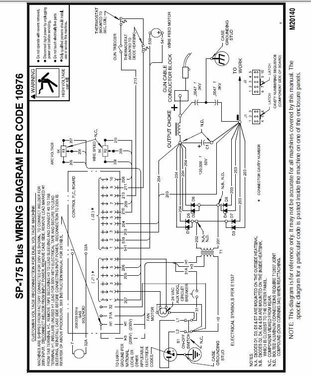

Report this Post01-08-2016 08:08 PM Click Here to See the Profile for 84fiero123Send a Private Message to 84fiero123Edit/Delete MessageReply w/QuoteDirect Link to This Post
Not sure Pokey, I haven't taken that side off the welder yet.
This is the wiring diagram, not that it does me any good, I keep forgetting what line I am following.
this is a picture I had on the computer of the front of mine, notice the knobs and switch are on the left side so it could be a board or rheostat soldered to a board, I forgot all about it today after almost running into the shop instead of just driving in. Tough to stop a vehicle with no brakes.
It may be a rheostat type control soldered to a board, it is that old. I said it was 10 years old but it maybe older, will have to look at the label tomorrow for its exact manufacture date. But it isn't one of the newer models, I don't think, first I need to figure out what is wrong with the dam plow trucks brakes but all ideas are helpful as they give me a place to start my search.
I really don't want to send it in, the local place I bought it from charges $75 an hour. + parts.
Thanks for all the ideas so far.

Pretty sure that is a solid state speed control dial.
That model is circuit board speed control. If it is working at higher settings it is a good bet it isn't a speed control problem.
If it is a board problem they can be replaced easy enough but they are pricey.
I just replaced a bad diode on mine that killed the speed control completely.
Lucky I found it or I would have had to replace the board. Cost a couple bucks and a bit of solder.
Check the resistance on the motor or use a cordless drill variable speed trigger control and test the motor on a bench.
I HATE technology, WTF is wrong with the old way it worked on every other welder I have had or even run on jobsites. This one will be expensive if it is on a board, it was the top of the line highest powered welder they made on the small size back then and to add insult to injury it has infinite power settings on the heat knob, no detents and can be changed on the fly, welding. I didn't want a monster that would take up enough space in the shop to put a couch in. I also wanted some portability, the big ones are a little tough to put in a truck even with ramps with a bad back, even on all the drugs I am on.
Pain in the ass, I hate electrical problems, I would rather pound my balls flat than hunt down an electrical problem.
So how do I test the switch if it is the switch alone or if its the board ?

The grease in the motor gearbox on mine didn't appreciate being exposed to sub-zero temps, all the oil suspended in the grease leaked out and left the gearbox full of thick/stiff crap, and it drew too much current and fried the circuit board. Different brand, mind you...
But, yeah, I'd check the motor/gearbox, and check the output of the speed circuitry to the motor...if the gearbox is stiff, it might be enough to stall the motor at lower speeds. Or there is a corrosion in the connections along the way, and it takes a certain voltage to overcome it. Or, finally, yes, the rheostat has gone bad...it's probably a pulse-width modulation circuit that uses a small rheostat as input to tell it how much power to put out, rather then a simple big rheostat that directly controls the motor by adjusting the resistance getting to it. There are dirt cheap PWM boards on ebay that would probably be suitable as a replacement...

Lincoln no longer sells the motor separate from the gear box. I just checked.
But!!!!!!
You don't read for **** .
Test the one you have first. Just test it god damn it!!
It is no ac. It is DC 24 vac max speed Variable. Use a battery and find a trigger from an old broken cordless drill to use as a variable trigger switch.
If the motor spins but not at lower speeds it may just need to be cleaned..
I could be something else but this is most likely and the easiest.
To check the output of the board to the motor use the meter set to 200 not 20 as shown and turn selector up and down to read the DC volts.
IF they go from zero to 24 then it isn't the board of the or the dial.
Connect to the two wires that connect to the motor via flat terminals. They just pull off and push on.
To test the dial use the ohm meter and connect to the two wires coming off the dial. Roll dial up and down and read resistance.

The latest version of my welder is this one,
http://www.eastwood.com/eas...der-lew-k2698-1.html
I bought this unit before my stroke in '03 and wanted portability to be able to just get up and go, throw the welder and extension cord in the bed of the truck and help a friend, if need be I could also throw my generator in the back and go out into a field and fix something.
http://parts.lincolnelectri..._PART_CODE=9sl7801-1
So $175 for the unit and the gear box comes with it. you can't buy the motor alone, so I need to find the time and remember to look at it before I start throwing money at this problem, I know all about testing parts just don't know how to test these parts and like others have said it may very well be grease in the motor has seized/hardened, hey it has sat in my un heated shop for at least 10 winters here in Maine where temps can get way down below zero for weeks on end at times. Could I possibly find just the motor from another place, sure but I want it to be the right part that will match up to mine, meaning I don't want it to run to fast or to slow, or to only last a year.

I don't see the wire feed assembly on any of the diagrams but I could have missed it.
http://parts.lincolnelectri...on.do?action=¶m=
Sorry this is my welder and the wirer feed button is a single POTENTIOMETER as well as the heat, those other links may be wrong for my welders part number, I will have to look but this one is my welders parts page.
I am headed to the shop to turn the heat on and work on the truck for now, keep the ideas coming and any tests you can think of. By the way all Lincolns welders use the same part number for the wirer drive motor and gearbox system and that is the only way to buy it, like I think Pokey said earlier, or maybe it was someone else. I can't remember.
